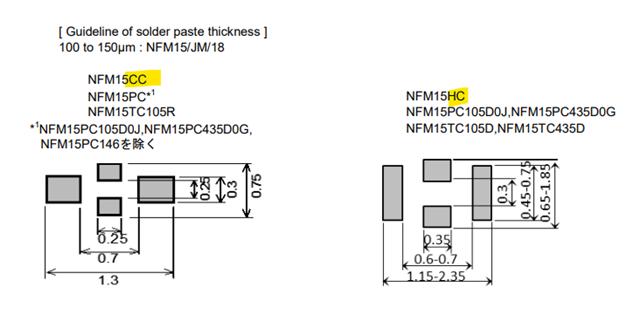

MURATA does not recommend using such a footprint, so why does TI's EVM use it this way?
Does NFM15HC105D0G use the NFM15CC footprint?
Does NFM18HC106D0G use the NFM18C footprint?

Hi Robert
Murata's recommendation:
The sizes are slightly different. To avoid interference, it is recommended to use different footprints.
So the customer wants to know why sk-am69 uses such a design.
Daniel
I don't see any difference is footprint from recommendation in data sheet. Can you please provide specifics of your concern? Which measurement(s) are you refering?

Recommendation is to use latest recommended PCB footprint from manufacturer (Murata). We started using these devices long ago (2018) and possible manufacturer has updated footprint (while TI still using initial created PCB footprint). I'm not aware of any build issue with our EVMs - but recommended using latest manufacturer recommendatiion.
Hi Robert,
From Murata's reply, the recommended footprint is NFM15HC

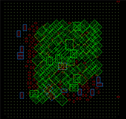

Why did TI create NFM15CC? Why did TI deliberately use the materials of NFM15HC and NFM18HC with the footprint of NFM15CC and NFM18CC?
In addition, if the EVM is placed according to Murata's suggestion, all parts will interfere with each other and there will be problems as follows

The NFM15HC footprint has significant tolerances and can be made to be similar to the NFM15CC footprint you provided.
The overall HC length (x-direction in my image) can range from 1.15 to 2.35mm. The 1.3mm dimension from CC is within that dimension.
The overall HS width (y-direction in my image) can range from 0.65 to 1.8fmm. The 0.75mm dimension from the CC is within that dimension.
