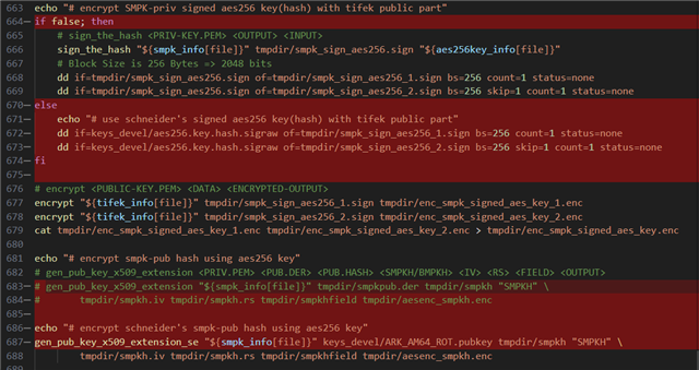

    ./gen_keywr_cert.sh -t tifek/ti_fek_public.pem --msv 0xC0FFE -a keys_devel/aes256.key --smpk-def --smek keys_devel/aes256.key --keycnt 1 --keyrev 1
    and changes made into 'gen_keywr_cert.sh':
    'aes256.key.hash.sigraw' is the signed aes256.key.hash.
    'keys_devel/ARK_AM64_ROT.pubkey' is the public key.
    This command will generate a x509 certificate, but it's signed with default SMPK key. So, afterward, we'll extract the TBS field, and signed by our company, and replace corresponding signature field.

    thanks for your attention, I though I've root cuase the issue. There's difference between 'keys_devel/ARK_AM64_ROT.pubkey' and publicKey required by 'gen_keywr_cert.sh'.
    Specifically, there's an extra 'rsaEncryptionDes' entry need to be added.
    With this change, OTP KeyWriter can succeed to program the OPT. I'll try to secure boot sbl today.
