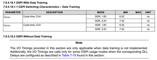

this is TI document, which does not give OSPI switching characteristics - data traning.
can you provide AC specification covering both requirements and switching characteristic ?

  • Hi Max,
    Table 6-107 OSPI Switching Characteristics – PHY Data TrainingSee Figure 6-90 and Figure 6-91

    (6) Minimum and maximum delay times for OSPI0/1_D[7:0] outputs are not defined when Data Training is used to find the optimum data valid window. The tDIVW parameter defines the maximum data invalid window. This parameter is provided in lieu of minimum and maximum delay times, where it must be used to check compatibility with the data valid window requirements of an attached device.
    These will be updated in the newest revision of the datasheet. For now, I have attached the timing requirements and switching characteristics for you here.
