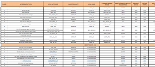

    So lets discuss about CONNECTION first. Please find the image below
    Ball number
    Address
    GPIO PIN (MCU header)
    Connection
    G23
    0x1AC
    13
    RXD
    G20
    0x1B0
    14
    TXD
    E25
    0x198
    8
    RTS
    D25
    0x194
    7
    CTS
    364     main_uart1_pins_default: main-uart1-default-pins {
    365         pinctrl-single,pins = <
    366             AM62PX_IOPAD(0x0194, PIN_INPUT, 2) /* (D25) MCASP0_AXR3.UART1_CTSn */
    367             AM62PX_IOPAD(0x0198, PIN_OUTPUT, 2) /* (E25) MCASP0_AXR2.UART1_RTSn */
    368             AM62PX_IOPAD(0x01ac, PIN_INPUT, 2) /* (G23) MCASP0_AFSR.UART1_RXD */
    369             AM62PX_IOPAD(0x01b0, PIN_OUTPUT, 2) /* (G20) MCASP0_ACLKR.UART1_TXD */
    370         >;
    371         bootph-all;
    372     };
    373

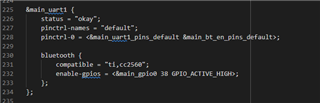

    Below is my addition:
    diff --git a/arch/arm64/boot/dts/ti/k3-am62p5-sk.dts b/arch/arm64/boot/dts/ti/k3-am62p5-sk.dts
    index dd9662d65..3f698f288 100644
    --- a/arch/arm64/boot/dts/ti/k3-am62p5-sk.dts
    +++ b/arch/arm64/boot/dts/ti/k3-am62p5-sk.dts
    @@ -371,6 +371,12 @@
                    bootph-all;
    +    main_bt_pins_deafult: main-bt-en-pins-default {
    +               pinctrl-single,pins = <
    +                       AM62PX_IOPAD(0x019c, PIN_OUTPUT, 7) /* (E24) MCASP0_AXR1.GPIO1_9 */
            main_usb1_pins_default: main-usb1-default-pins {
                            AM62PX_IOPAD(0x0258, PIN_INPUT, 0) /* (G21) USB1_DRVVBUS */
    @@ -807,11 +813,14 @@
     &main_uart1 {
    +       status = "okay";
            pinctrl-names = "default";
    -       pinctrl-0 = <&main_uart1_pins_default>;
    -       /* Main UART1 is used by TIFS firmware */
    -       status = "reserved";
    -       bootph-all;
    +       pinctrl-0 = <&main_uart1_pins_default &main_bt_pins_deafult>;
    +       bluetooth {
    +               compatible = "ti,cc2560";
    +               enable-gpios = <&main_gpio0 9 GPIO_ACTIVE_HIGH>;
     &mcu_pmx0 {

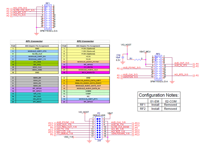

    is there a particular reason you want to use the ST adapter board?. That board is specifically created to route all the needed lines from the ST board to the CC256x EVM RF connectors. However since you are using an am62, theres no reason to use it, as it just adds a middle layer of confusion.
    Here are the schematics for the evm.
    CC256xCQFN-EM_Schematic_10182016.pdf
    In Regards, to power and ground. The EVM needs to be powered by 3.3V and the ground would connect to the ground on the am62 evm.
    Here is the am62 schematic.
    sprr487b.zip
    Once you have the UART connection the BLE_enable pin and ground pin and 3.3V power pin routed correctly we can move on to the next step. In verifying the connection.

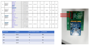

  • Dear Rogelio,
    No, it was actually recommended by TI when we had a discussion to enable BT.
    However, we have now changed it to use the chip independently. See picture below.
    We mapped the connection setup like above. Could you please confirm?
    User Expansion connector(j4):https://www.ti.com/lit/ug/spruja2/spruja2.pdf
    Pin Attributes: https://www.ti.com/lit/ds/symlink/am62p.pdf?ts=1746422064230
    1. If the connection is right, could you verify if the DTS patch is right? Can kernel log confirm it?
    2. What will be device name (serial port) /dev/ttyS0? How do we confirm the device name?
    Libin Jose.

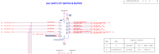

    I apologize for the delay here, I have gone over the schematics and dts file and have the following comments.
    The dts file uart lines and enable line seems configures correctly. However be aware that you might have to populate r214 and depopulate r216 if it hasnt been done on your board.
    This is because the UART1_FET_SEL  needs to be LOW to select the expansion connector. By default it is high.
    You will also need to make sure to add the UART1_FET_BUF_EN to be high. This is done also in the dts file.
    Once you have those additions you should be able to wire up the CC2564 and am62. From there the device should load the bluetooth fw with the hcill driver. You can confirm it is working  by calling hciconfig hci0 -a and see there is an hci0.

  • Hi Libin,
    From the Schematic I see that FET Select is either pullled high or low with physical resistors. You would need to desolder r214 which is pulling the line to ground, and populate resistor r216 to make it high.
    in regards to the FET Enable it seems as though by default it is active high
    Rogelio

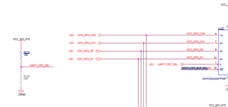

  • Dear ,
    Please find the attached image. From visual inspection of the evaluation board, it seems that R214 is by default depopulated and r216 is populated. So we believe, there is no change required at hardware level. Could you verify that our understanding is right?
    Libin Jose
  • Hi Libin,
    Thank you for verifying the r214 is indeed depopulated and r216 is populated. I think you may have gotten mixed up, but that means that you will have to remove the resistor from r216 and place it on r214
    This will pull the FET SEL to LOW which is what you want to select the expansion header
    Rogelio
