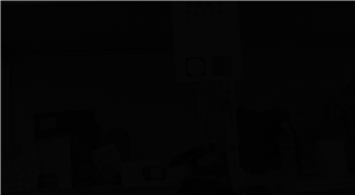

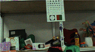

  • As shown in the figure below, the left picture is the result of the tool test, and the right picture is the output result of the model on the PC.
    We have tried many quantization methods, but the results are not correct. Please provide an import configuration file that can correctly quantize the model.
