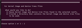

  • I am using "Create SD Card with custom images" and selected "Enter in custom boot and rootfs file paths". I entered the Boot Partition path, but I don’t know how to choose the ROOT path. I selected the option: "Provide a directory that contains the kernel image and device tree files to be used" because I want to use my own kernel image and device tree files. However, how should this path be configured? Do I need to place all the compiled device tree images and kernel images from the SDK into a single folder? Additionally, after completing this option, it asks me to select the rootfs path again. Can I use the default rootfs file from the system’s built-in filesystem?
  • I selected the option: "Provide a directory that contains the kernel image and device tree files to be used" because I want to use my own kernel image and device tree files. However, how should this path be configured? Do I need to place all the compiled device tree images and kernel images from the SDK into a single folder? Additionally, after completing this option, it asks me to select the rootfs path again.
    I'm not too familiar with the exact operation of the script when applying such customizations but you can just look at its source code and you'll see exactly where it will be trying to pull files from for Kernel, DTB, and rootfs in accordance with the options that are selected.
    Another (more straightforward way I think) would be to just program an initial SD card image with everything the SDK provides; and then mount this image (via SD card reader) and replace the files you want to replace. Note that if you replace the kernel you typically also want to update the kernel modules in sync with it to maintain compatibility (otherwise none of the kernel modules will get loaded).
    I still think the best is to use Yocto to just generate a new ready-to-flash WIC image directly. This also has the advantage that all your changes are immediately ready to re-build and re-deploy any time in a repeatable and organized fashion (rather than relying on some scripting and manual command selections etc.)
    Yes that shouldn't be an issue.
