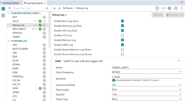

The R5 .syscfg about MAIN UART1 is like below,
I don't know why the uboot2021 works, but uboot2023 does not work. Please help to give some suggestions, thank you!

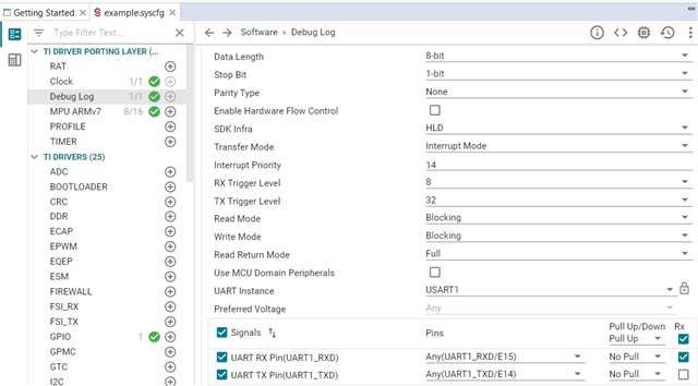

    In the kernel dts, we have disabled the pins mode configure, and disabled MAIN_UART1 like bellow,
        main_uart1_pins_default: main-uart1-pins-default {
    		pinctrl-single,pins = <
    			/* AM64X_IOPAD(0x024c, PIN_OUTPUT, 7) /* (E16) UART1_485_DIR GPIO1.59*/
                /* AM64X_IOPAD(0x0240, PIN_INPUT, 0)  /* (E15) UART1_RXD */
    			/* AM64X_IOPAD(0x0244, PIN_OUTPUT, 0) /* (E14) UART1_TXD */
                /* AM64X_IOPAD(0x017c, PIN_INPUT, 7)  /* (T1) UART1_485_Error GPIO1.7*/
    &main_uart1 {
    	status = "disabled";
    	pinctrl-names = "default";
    	pinctrl-0 = <&main_uart1_pins_default>;
    	rs485-rts-active-low;
    	rs485-rx-during-tx;
    	rs485-rts-delay = <1 0>;
    	linux,rs485-enabled-at-boot-time;

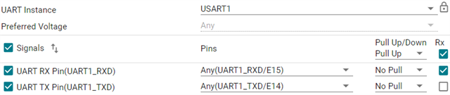

    So I think the R5 firmware take care of the MAIN UART1 pins configure in example.syscfg like bellow,
    And I think it's correct, because uboot2021 works with these configures.
    I'm really confused too. And I checked after the system started, the 0xF4240 and 0xF4244 values are,
