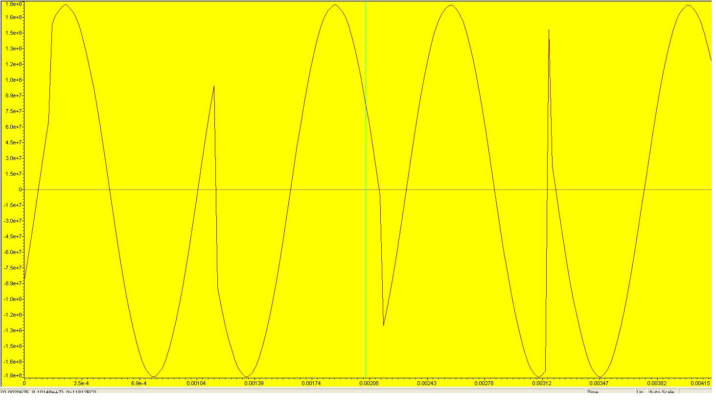

  • Are the shared data buffers in L1 or L2 memory?  If not, you will need to perform some manual cache operations to maintain coherence.
    Can you provide more detail related to the data loss?  How much data and how often? Is it periodic?  Is it correlated to anything else in the system?
    Here are some other thoughts:
    • Turn on the audio FIFO for the McASP (even with theshold=1 if you're concerned about latency).  Reading from the FIFO rather than config bus will also give a performance improvement.
    • Take a look at your EDMA assignments
      • What other EDMA traffic is being assigned to the same queue?  For best latency, make this the only transfer happening on the associated TC.
      • What priority is the TC on the SCR interconnect?  Make it the highest priority.
    Everything is in internal memory.  External or other memory is not involved in this example.

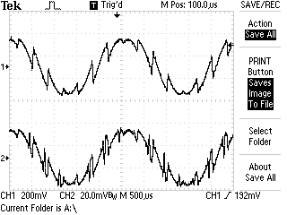

    Attached is a snapshot of a animated graph /probe point for rcv_ping_L of audio.c
    As you can see it is doping samples on the input.  (As long as the animated brake point is not messing up the actual rec ? could be ?)
    >How much data and how often?    See attached (if that helps) ?
    Actuall view of DtoA out with a sign wave in to AtoD.
    >Is it periodic?   (? see above)
    >Is it correlated to anything else in the system?  Not that I can tell....
