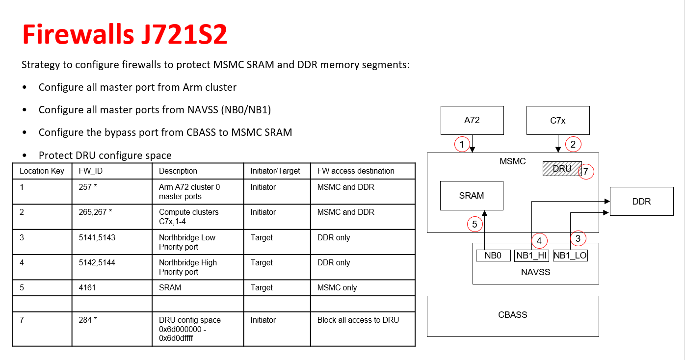

We are currently trying to setup firewalls to protect the DDR memory.
The goal is to setup several regions which only some can access.
Example:
Area 1 only A72 can access
Area 2 only R5_MCU can access.
Area 3 only C7x can access.
The firewalls that we could find in the TRM for the area are: 1280,  5142, 5143,5142. Which of this would be the correct one?
Could we also use just the DRU firewall 284 to control the access to the DDR areas ?
If this is not enough could you please clarify what else might be needed?
