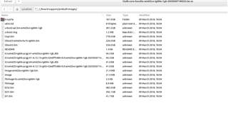

  • Hi Andreas,
    I am building the tisdk-core-bundle because it includes all the required prebuilt binaries as well as the corresponding source code, including my custom changes. This bundle is essential when delivering to others, as it allows me to provide both the binaries and the modified source code along with the custom board.
    However, after applying my changes, I noticed that the Linux and U-Boot source code was missing from the board-support directory. This is why I'm focusing on properly building the tisdk-core-bundle to ensure everything is included for delivery.

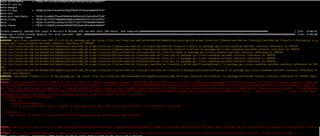

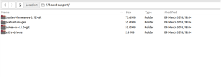

  • Hi Andreas,
    I have tried but still i was unable to get the complete source using tisdk-core-bundle image.During AM62A Processor yocto build i was able to get the source of atf,opte,u-boot & kernel with my updated changes to the evk source. So i wanted to replicate the same here in am62l.
    As you can see i have generated my custom binaries.
    But not the complete source of this (kernel & u-boot is missing )
    It would be really helpfull if you can help me solve this.

    Check for U-Boot and Kernel source files after building  the `tisdk-core-bundle` target:
    # Create text document with list of files in the archive that was generated
    a0797059@jiji:~/tisdk/am62lxx-evm/build (master)
    $ tar -tvf deploy-ti/images/am62lxx-custom/tisdk-core-bundle-am62lxx-custom.tar.xz > tisdk-core-bundle-am62lxx-custom.tar.xz.txt
    # Check for U-Boot sources
    $ grep ti-u-boot- tisdk-core-bundle-am62lxx-custom.tar.xz.txt | head
    drwxr-xr-x 0/0               0 2018-03-09 06:34 ./board-support/ti-u-boot-2025.01+git/
    -rw-r--r-- 0/0           25723 2018-03-09 06:34 ./board-support/ti-u-boot-2025.01+git/.azure-pipelines.yml
    -rw-r--r-- 0/0             814 2018-03-09 06:34 ./board-support/ti-u-boot-2025.01+git/.checkpatch.conf
    -rw-r--r-- 0/0              50 2018-03-09 06:34 ./board-support/ti-u-boot-2025.01+git/.get_maintainer.conf
    -rw-r--r-- 0/0              32 2018-03-09 06:34 ./board-support/ti-u-boot-2025.01+git/.get_maintainer.ignore
    drwxr-xr-x 0/0               0 2018-03-09 06:34 ./board-support/ti-u-boot-2025.01+git/.git/
    -rw-r--r-- 0/0              34 2018-03-09 06:34 ./board-support/ti-u-boot-2025.01+git/.git/HEAD
    drwxr-xr-x 0/0               0 2018-03-09 06:34 ./board-support/ti-u-boot-2025.01+git/.git/branches/
    -rw-r--r-- 0/0             355 2018-03-09 06:34 ./board-support/ti-u-boot-2025.01+git/.git/config
    -rw-r--r-- 0/0              73 2018-03-09 06:34 ./board-support/ti-u-boot-2025.01+git/.git/description
    # Check for Kernel sources
    $ grep ti-linux-kernel- tisdk-core-bundle-am62lxx-custom.tar.xz.txt | head
    drwxr-xr-x 0/0               0 2018-03-09 06:34 ./board-support/ti-linux-kernel-6.12.24+git-ti/
    -rw-r--r-- 0/0           22878 2018-03-09 06:34 ./board-support/ti-linux-kernel-6.12.24+git-ti/.clang-format
    -rw-r--r-- 0/0             335 2018-03-09 06:34 ./board-support/ti-linux-kernel-6.12.24+git-ti/.clippy.toml
    -rw-r--r-- 0/0              59 2018-03-09 06:34 ./board-support/ti-linux-kernel-6.12.24+git-ti/.cocciconfig
    -rw-r--r-- 0/0             575 2018-03-09 06:34 ./board-support/ti-linux-kernel-6.12.24+git-ti/.editorconfig
    -rw-r--r-- 0/0             194 2018-03-09 06:34 ./board-support/ti-linux-kernel-6.12.24+git-ti/.get_maintainer.ignore
    drwxr-xr-x 0/0               0 2018-03-09 06:34 ./board-support/ti-linux-kernel-6.12.24+git-ti/.git/
    -rw-r--r-- 0/0              32 2018-03-09 06:34 ./board-support/ti-linux-kernel-6.12.24+git-ti/.git/HEAD
    drwxr-xr-x 0/0               0 2018-03-09 06:34 ./board-support/ti-linux-kernel-6.12.24+git-ti/.git/branches/
    -rw-r--r-- 0/0             363 2018-03-09 06:34 ./board-support/ti-linux-kernel-6.12.24+git-ti/.git/config
    Can you see if you can re-create this?
    There might be something off with the way the your custom machine was added to the Yocto sources.
    Regards, Andreas
