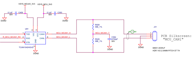

I am working with the J7200 EVM, which uses the DRA821 SoC, and I would like to clarify the CAN bus termination requirements.
As I understand, the DRA821 SoC does not include internal CAN bus termination resistors. Could you please confirm if the J7200 EVM provides onboard termination resistors for CAN, or if I need to add external 120-ohm resistors at the ends of the CAN bus for proper operation?
