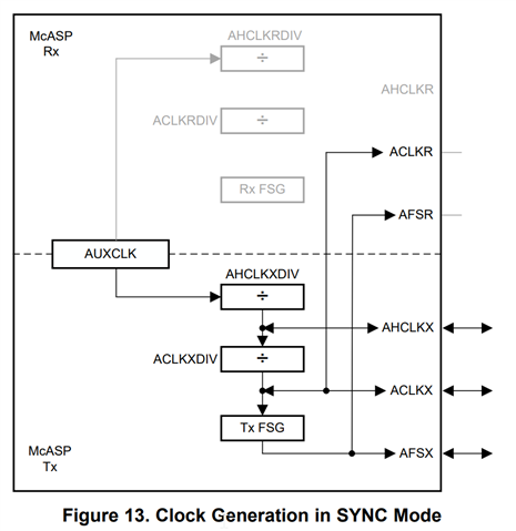

Hi expert,
In the below guide, we find we can map McASP TX clock to RX internally. We would like to know if we can map RX clk to TX? Thanks
https://www.ti.com/lit/an/sprack0/sprack0.pdf?ts=1745549712475

Hi Xingyu,
In the synchronous operation, the whole receiver clock logic is bypassed and the bit clock is derived from the transmit clock. The vice versa is not possible.
