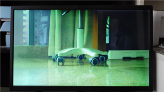

Hi TI Experts
After executing the AWB tuning of the DCC tool, the screen turned green.
Please tell me how to solve this problem.
The specific operation process is in the doc document.

Hi TI Experts

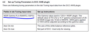

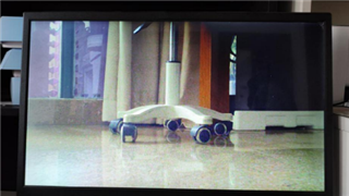

Hi Meng,

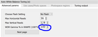

Thanks for sharing the XML files. I noticed you had a gamma in your tuning:
Please set the WDR Gamma to 100 in the AWB tuning -> Advanced params:
This is the gamma valued used for WDR sensors. It should be set to 100 for linear sensors like IMX219. Please refer to the AWB Plugin User Guide:
