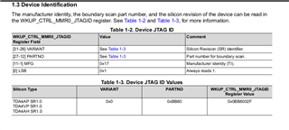

There is a way to distinguish parts with different base part numbers, based on JTAG_USER_ID register. This is not documented broadly, since TI SDKs do not support feature enable/disable based on that register.

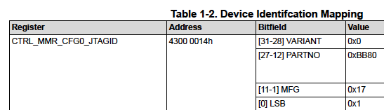

To differentiate across the superset devices you can use the JTAG_ID, that is in the device TRM.
E.g., TDA4VH JTAG_ID:
Kyle
and what is the expected value to be read from this register for each variant?
Please refer to the TRM for the JTAG ID of each variant.

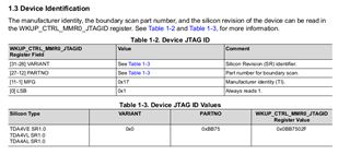

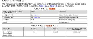

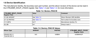

I have provided the JTAG ID data of each variant below for your reference.
TDA4VL:
TDA4VM:
TDA4VH:
