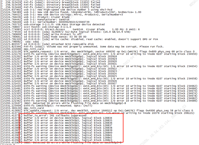

On some customer project's boards, have issue as below log:
Issue similar as this thread: https://e2e.ti.com/support/processors-group/processors/f/processors-forum/1327667/am625-emmc-tranision-issue/
The patch is based on SDK8.6 or later, I tried to make a patch according to SDK9.2. but can't apply to SDK8.3 as there is no member named 'itap_del_ena' in structure sdhci_am654_data.
https://e2e.ti.com/cfs-file/__key/communityserver-discussions-components-files/791/sdk8_5F00_3.patch
Questions:
#1. What is the reason of the error?
#2. Need a patch for SDK8.3 for this issue.

  • #1. On customer's board, the error can be eliminated by change the serial resistor on DAT line from 0ohm to 33ohm or 22ohm.
    #2. Applied log print in tuning process, with SDK8.3 +SK-AM62, it keeps output tuning result when copy data from SD card to eMMC.
  • Tony,
    One of the difference of the MMC controller driver in SDK8.3 and 9.2 is that in drivers/mmc/host/sdhci_am654.c:
    in sdk8.3:
        #define SDHCI_AM654_AUTOSUSPEND_DELAY  100
    in sdk9.2:
        #define SDHCI_AM654_AUTOSUSPEND_DELAY  -1
    Can you please ask the customer to change this macro to '-1' in sdk8.3 to see if the HS200 tuning is till called multiple times when copying data?
  • #1. Sees no more randomly tunning triggered with the modification when copy a larger file within eMMC or between eMMC and SD card.

    #2. Still there are many IO/CRC/CQE recovery error when copy file system from SD card to eMMC partition.

    [  834.149719] blk_update_request: I/O error, dev mmcblk0, sector 829440 op 0x1:(WRITE) flags 0x0 phys_seg 3 prio class 0
    [  834.160643] EXT4-fs warning (device mmcblk0p1): ext4_end_bio:345: I/O error 10 writing to inode 130335 starting block 103711)
    [  834.172696] Buffer I/O error on device mmcblk0p1, logical block 103424
    [  834.178938] mmc0: running CQE recovery
    [  834.180480] Buffer I/O error on device mmcblk0p1, logical block 103425
    [  834.184456] blk_update_request: I/O error, dev mmcblk0, sector 854016 op 0x1:(WRITE) flags 0x0 phys_seg 8 prio class 0
    [  834.189778] Buffer I/O error on device mmcblk0p1, logical block 103426
    [  834.200393] EXT4-fs warning (device mmcblk0p1): ext4_end_bio:345: I/O error 10 writing to inode 130338 starting block 106862)
    [  834.206955] Buffer I/O error on device mmcblk0p1, logical block 103427
    [  834.222240] mmc0: running CQE recovery
    [  834.224853] Buffer I/O error on device mmcblk0p1, logical block 103428
    [  834.233740] mmc0: running CQE recovery
    [  834.235171] Buffer I/O error on device mmcblk0p1, logical block 103429
    [  834.245562] Buffer I/O error on device mmcblk0p1, logical block 103430
    [  834.252663] Buffer I/O error on device mmcblk0p1, logical block 103431
    [  834.253398] mmc0: running CQE recovery
    [  834.259770] Buffer I/O error on device mmcblk0p1, logical block 103432
    [  834.269712] Buffer I/O error on device mmcblk0p1, logical block 103433
    [  834.269822] mmc0: running CQE recovery
    [  834.318608] mmc0: running CQE recovery
    [  834.328820] mmc0: running CQE recovery
    [  834.360691] mmc0: running CQE recovery
    [  834.368181] mmc0: running CQE recovery
    [  834.382284] mmc0: running CQE recovery
    [  834.397788] mmc0: running CQE recovery
    [  834.412691] mmc0: running CQE recovery
    [  834.421745] mmc0: running CQE recovery
    [  834.432358] mmc0: running CQE recovery
    [  834.438151] mmc0: running CQE recovery
    [  834.446976] blk_update_request: I/O error, dev mmcblk0, sector 821248 op 0x1:(WRITE) flags 0x0 phys_seg 34 prio class 0
    [  834.458047] EXT4-fs warning (device mmcblk0p1): ext4_end_bio:345: I/O error 10 writing to inode 130334 starting block 102762)
    [  834.471011] mmc0: running CQE recovery

    [  896.094933] mmc0: cqhci: Config:    0x00000101 | Control:  0x00000000
    [  896.101463] mmc0: cqhci: Int stat:  0x00000000 | Int enab: 0x00000006
    [  896.107983] mmc0: cqhci: Int sig:   0x00000006 | Int Coal: 0x00000000
    [  896.114542] mmc0: cqhci: TDL base:  0x80ecf000 | TDL up32: 0x00000000
    [  896.121080] mmc0: cqhci: Doorbell:  0xffffffff | TCN:      0x00000000
    [  896.127615] mmc0: cqhci: Dev queue: 0x00000000 | Dev Pend: 0x00000000
    [  896.134123] mmc0: cqhci: Task clr:  0x00000000 | SSC1:     0x00011000
    [  896.140648] mmc0: cqhci: SSC2:      0x00000001 | DCMD rsp: 0x00000000
    [  896.147170] mmc0: cqhci: RED mask:  0xfdf9a080 | TERRI:    0x9b2f092c
    [  896.153653] mmc0: cqhci: Resp idx:  0x0000002d | Resp arg: 0x00000d00
    [  896.160156] mmc0: sdhci: ============ SDHCI REGISTER DUMP ===========
    [  896.166675] mmc0: sdhci: Sys addr:  0x00000400 | Version:  0x00001004
    [  896.173207] mmc0: sdhci: Blk size:  0x00007080 | Blk cnt:  0x00000000
    [  896.179714] mmc0: sdhci: Argument:  0x00000000 | Trn mode: 0x00000013
    [  896.186228] mmc0: sdhci: Present:   0x01ff00f0 | Host ctl: 0x0000003c
    [  896.192837] mmc0: sdhci: Power:     0x0000000f | Blk gap:  0x00000080
    [  896.199534] mmc0: sdhci: Wake-up:   0x00000000 | Clock:    0x00000007
    [  896.206051] mmc0: sdhci: Timeout:   0x0000000e | Int stat: 0x00000000
    [  896.212575] mmc0: sdhci: Int enab:  0x02ff4000 | Sig enab: 0x02ff4000
    [  896.219098] mmc0: sdhci: ACmd stat: 0x00000000 | Slot int: 0x00000000
    [  896.225641] mmc0: sdhci: Caps:      0x3decc801 | Caps_1:   0x18002407
    [  896.232151] mmc0: sdhci: Cmd:       0x0000153a | Max curr: 0x00000000
    [  896.238672] mmc0: sdhci: Resp[0]:   0x00000900 | Resp[1]:  0xffc003ff
    [  896.245166] mmc0: sdhci: Resp[2]:   0x328f5903 | Resp[3]:  0x00d07f01
    [  896.251687] mmc0: sdhci: Host ctl2: 0x0000000b
    [  896.256221] mmc0: sdhci: ADMA Err:  0x00000000 | ADMA Ptr: 0x0000000080ecb20c
    [  896.263437] mmc0: sdhci: ============================================
    [  896.270017] mmc0: running CQE recovery
    [  896.278027] mmc0: running CQE recovery
    [  896.290157] mmc0: running CQE recovery
    [  896.301890] mmc0: running CQE recovery
    [  896.307845] mmc0: running CQE recovery
    [  896.316969] mmc0: running CQE recovery
    [  896.325833] mmc0: running CQE recovery
    [  896.335405] blk_update_request: I/O error, dev mmcblk0, sector 875520 op 0x1:(WRITE) flags 0x4000 phys_seg 96 prio class 0
    [  896.348748] mmc0: running CQE recovery
    [  896.359250] mmc0: running CQE recovery
    [  896.370121] mmc0: running CQE recovery
    [  896.375492] mmc0: running CQE recovery
    [  896.385729] mmc0: running CQE recovery
    [  896.397297] mmc0: running CQE recovery
    [  896.407668] mmc0: running CQE recovery
    [  896.418783] mmc0: running CQE recovery
    [  896.428776] mmc0: running CQE recovery
    [  896.437875] blk_update_request: I/O error, dev mmcblk0, sector 876544 op 0x1:(WRITE) flags 0x4000 phys_seg 22 prio class 0
    [  896.450235] mmc0: running CQE recovery
    [  896.458809] blk_update_request: I/O error, dev mmcblk0, sector 827392 op 0x1:(WRITE) flags 0x4000 phys_seg 127 prio class 0
    [  896.479967] mmc0: running CQE recovery
    [  896.500183] mmc0: running CQE recovery
    [  896.508979] mmc0: running CQE recovery
    [  896.514764] blk_update_request: I/O error, dev mmcblk0, sector 852832 op 0x1:(WRITE) flags 0x4000 phys_seg 16 prio class 0
    [  896.527226] mmc0: running CQE recovery
    [  896.544055] mmc0: running CQE recovery
    [  896.567383] mmc0: running CQE recovery
    [  896.575657] blk_update_request: I/O error, dev mmcblk0, sector 868352 op 0x1:(WRITE) flags 0x4000 phys_seg 10 prio class 0
    [  896.603835] mmc0: running CQE recovery
    [  896.613397] mmc0: running CQE recovery
    [  896.618030] blk_update_request: I/O error, dev mmcblk0, sector 836792 op 0x1:(WRITE) flags 0x0 phys_seg 18 prio class 0
    [  896.629350] EXT4-fs warning (device mmcblk0p1): ext4_end_bio:345: I/O error 10 writing to inode 130336 starting block 104704)
    [  896.641303] i = 0: pass
    [  896.644114] i = 1: pass
    [  896.646801] i = 2: pass
    [  896.649414] i = 3: pass
    [  896.652135] i = 4: pass
    [  896.654788] i = 5: pass
    [  896.657399] i = 6: pass
    [  896.660070] i = 7: pass
    [  896.662731] i = 8: pass
    [  896.665304] i = 9: pass
    [  896.667906] i = 10: pass
    [  896.670633] i = 11: pass
    [  896.673326] i = 12: pass
    [  896.676043] i = 13: pass
    [  896.678675] i = 14: pass
    [  896.681244] i = 15: pass
    [  896.683833] i = 16: pass
    [  896.686440] i = 17: pass
    [  896.689092] i = 18: pass
    [  896.691732] i = 19: pass
    [  896.694360] i = 20: pass
    [  896.696973] i = 21: fail
    [  896.699613] i = 22: fail
    [  896.702315] i = 23: pass
    [  896.705000] i = 24: pass
    [  896.707712] i = 25: pass
    [  896.710430] i = 26: pass
    [  896.713157] i = 27: pass
    [  896.715979] i = 28: pass
    [  896.718748] i = 29: pass
    [  896.721411] i = 30: pass
    [  896.724140] i = 31: pass
    [  896.726739] itap = 6
    [  957.517714] mmc0: cqhci: timeout for tag 0
    [  957.522049] mmc0: cqhci: ============ CQHCI REGISTER DUMP ===========
    [  957.528694] mmc0: cqhci: Caps:      0x000030c8 | Version:  0x00000510
    [  957.535346] mmc0: cqhci: Config:    0x00000101 | Control:  0x00000000
    [  957.541970] mmc0: cqhci: Int stat:  0x00000000 | Int enab: 0x00000006
    [  957.548624] mmc0: cqhci: Int sig:   0x00000006 | Int Coal: 0x00000000
    [  957.555311] mmc0: cqhci: TDL base:  0x80ecf000 | TDL up32: 0x00000000
    [  957.561947] mmc0: cqhci: Doorbell:  0xffffffff | TCN:      0x00000000
    [  957.568572] mmc0: cqhci: Dev queue: 0x00000000 | Dev Pend: 0x00000000
    [  957.575185] mmc0: cqhci: Task clr:  0x00000000 | SSC1:     0x00011000
    [  957.581810] mmc0: cqhci: SSC2:      0x00000001 | DCMD rsp: 0x00000000
    [  957.588450] mmc0: cqhci: RED mask:  0xfdf9a080 | TERRI:    0x9e2f012c
    [  957.595105] mmc0: cqhci: Resp idx:  0x0000002f | Resp arg: 0x00000900
    [  957.601728] mmc0: sdhci: ============ SDHCI REGISTER DUMP ===========
    [  957.608396] mmc0: sdhci: Sys addr:  0x00000378 | Version:  0x00001004
    [  957.614985] mmc0: sdhci: Blk size:  0x00007080 | Blk cnt:  0x00000000
    [  957.621594] mmc0: sdhci: Argument:  0x00000000 | Trn mode: 0x00000013
    [  957.628201] mmc0: sdhci: Present:   0x01ff00f0 | Host ctl: 0x0000003c
    [  957.634745] mmc0: sdhci: Power:     0x0000000f | Blk gap:  0x00000080
    [  957.641380] mmc0: sdhci: Wake-up:   0x00000000 | Clock:    0x00000007
    [  957.647928] mmc0: sdhci: Timeout:   0x0000000e | Int stat: 0x00000000
    [  957.654443] mmc0: sdhci: Int enab:  0x02ff4000 | Sig enab: 0x02ff4000
    [  957.660981] mmc0: sdhci: ACmd stat: 0x00000000 | Slot int: 0x00000000
    [  957.667521] mmc0: sdhci: Caps:      0x3decc801 | Caps_1:   0x18002407
    [  957.674034] mmc0: sdhci: Cmd:       0x0000153a | Max curr: 0x00000000
    [  957.680575] mmc0: sdhci: Resp[0]:   0x00000900 | Resp[1]:  0xffc003ff
    [  957.687130] mmc0: sdhci: Resp[2]:   0x328f5903 | Resp[3]:  0x00d07f01
    [  957.693657] mmc0: sdhci: Host ctl2: 0x0000000b
    [  957.698169] mmc0: sdhci: ADMA Err:  0x00000000 | ADMA Ptr: 0x0000000080ecb20c
    [  957.705378] mmc0: sdhci: ============================================
    [  957.711977] mmc0: running CQE recovery
    [  957.723979] mmc0: running CQE recovery
    [  957.730174] mmc0: running CQE recovery
    [  957.735092] mmc0: running CQE recovery
    [  957.740631] mmc0: running CQE recovery
    [  957.752617] mmc0: running CQE recovery
    [  957.762186] blk_update_request: I/O error, dev mmcblk0, sector 826368 op 0x1:(WRITE) flags 0x4000 phys_seg 25 prio class 0
    [  957.782985] mmc0: running CQE recovery
    [  957.789020] mmc0: running CQE recovery
    [  957.793972] mmc0: running CQE recovery
    [  957.798779] blk_update_request: I/O error, dev mmcblk0, sector 886784 op 0x1:(WRITE) flags 0x4000 phys_seg 10 prio class 0
    [  957.812297] mmc0: running CQE recovery
    [  957.818471] mmc0: running CQE recovery
    [  957.824442] mmc0: running CQE recovery
    [  957.835142] mmc0: running CQE recovery
    [  957.843769] blk_update_request: I/O error, dev mmcblk0, sector 842752 op 0x1:(WRITE) flags 0x4000 phys_seg 43 prio class 0
    [  957.856626] mmc0: running CQE recovery
    [  957.876466] mmc0: running CQE recovery
    [  957.881221] blk_update_request: I/O error, dev mmcblk0, sector 843776 op 0x1:(WRITE) flags 0x4000 phys_seg 35 prio class 0
    [  957.925678] mmc0: running CQE recovery
    [  957.934373] blk_update_request: I/O error, dev mmcblk0, sector 865280 op 0x1:(WRITE) flags 0x0 phys_seg 37 prio class 0
    [  957.978868] mmc0: running CQE recovery
    [  957.997076] mmc0: running CQE recovery
    [  958.018271] mmc0: running CQE recovery
    [  958.038040] mmc0: running CQE recovery
    [  958.059184] buffer_io_error: 237 callbacks suppressed
    [  958.059199] Buffer I/O error on device mmcblk0p1, logical block 104343
    [  958.071166] mmc0: running CQE recovery
    [  958.075172] Buffer I/O error on device mmcblk0p1, logical block 104344
    [  958.076311] blk_update_request: I/O error, dev mmcblk0, sector 893952 op 0x1:(WRITE) flags 0x0 phys_seg 66 prio class 0
    [  958.082449] Buffer I/O error on device mmcblk0p1, logical block 104345
    [  958.098943] mmc0: running CQE recovery
    [  958.099858] Buffer I/O error on device mmcblk0p1, logical block 104346
    [  958.107986] blk_update_request: I/O error, dev mmcblk0, sector 864256 op 0x1:(WRITE) flags 0x4000 phys_seg 82 prio class 0
    [  958.109954] Buffer I/O error on device mmcblk0p1, logical block 104347
    [  958.127263] Buffer I/O error on device mmcblk0p1, logical block 104348
    [  958.135249] mmc0: running CQE recovery
    [  958.137990] Buffer I/O error on device mmcblk0p1, logical block 104349
    [  958.145765] Buffer I/O error on device mmcblk0p1, logical block 104350
    [  958.147381] mmc0: running CQE recovery
    [  958.152421] Buffer I/O error on device mmcblk0p1, logical block 104351
    [  958.152430] Buffer I/O error on device mmcblk0p1, logical block 104352
    [  958.173778] blk_update_request: I/O error, dev mmcblk0, sector 885936 op 0x1:(WRITE) flags 0x0 phys_seg 45 prio class 0
    [  958.188314] EXT4-fs warning (device mmcblk0p1): ext4_end_bio:345: I/O error 10 writing to inode 130343 starting block 110848)
    [  958.207174] mmc0: running CQE recovery
    [  958.217120] mmc0: running CQE recovery
    [  958.231682] mmc0: running CQE recovery
    [  958.237282] blk_update_request: I/O error, dev mmcblk0, sector 803840 op 0x1:(WRITE) flags 0x0 phys_seg 66 prio class 0
    [  958.250656] mmc0: running CQE recovery
    [  958.258643] mmc0: running CQE recovery
    [  958.265658] mmc0: running CQE recovery
    [  958.287433] mmc0: running CQE recovery
    [  958.298535] blk_update_request: I/O error, dev mmcblk0, sector 877568 op 0x1:(WRITE) flags 0x4000 phys_seg 55 prio class 0
    [  958.309773] EXT4-fs warning (device mmcblk0p1): ext4_end_bio:345: I/O error 10 writing to inode 130342 starting block 109824)
    [  958.340126] mmc0: running CQE recovery
    [  958.350042] mmc0: running CQE recovery
    [  958.360650] mmc0: running CQE recovery
    [  958.369513] EXT4-fs warning (device mmcblk0p1): ext4_end_bio:345: I/O error 10 writing to inode 130339 starting block 107776)
    [  958.382458] i = 0: pass
    [  958.385091] i = 1: pass
    [  958.387855] i = 2: pass
    [  958.390517] i = 3: pass
    [  958.393117] i = 4: pass
    [  958.395844] i = 5: pass
    [  958.398467] i = 6: pass
    [  958.401049] i = 7: pass
    [  958.403767] i = 8: pass
    [  958.406446] i = 9: pass
    [  958.409076] i = 10: pass
    [  958.411838] i = 11: pass
    [  958.414650] i = 12: pass
    [  958.417356] i = 13: pass
    [  958.420132] i = 14: pass
    [  958.422897] i = 15: pass
    [  958.425616] i = 16: pass
    [  958.428305] i = 17: pass
    [  958.431054] i = 18: pass
    [  958.433781] i = 19: pass
    [  958.436484] i = 20: pass
    [  958.439364] i = 21: fail
    [  958.442194] i = 22: fail
    [  958.444938] i = 23: fail
    [  958.447773] i = 24: pass
    [  958.450540] i = 25: pass
    [  958.453246] i = 26: pass
    [  958.456025] i = 27: pass
    [  958.458806] i = 28: pass
    [  958.461500] i = 29: pass
    [  958.464268] i = 30: pass
    [  958.467048] i = 31: pass
    [  958.469665] itap = 6
    [ 1018.961719] mmc0: cqhci: timeout for tag 0
    [ 1018.965907] mmc0: cqhci: ============ CQHCI REGISTER DUMP ===========
    [ 1018.972487] mmc0: cqhci: Caps:      0x000030c8 | Version:  0x00000510
    [ 1018.979002] mmc0: cqhci: Config:    0x00000101 | Control:  0x00000000
    [ 1018.985664] mmc0: cqhci: Int stat:  0x00000000 | Int enab: 0x00000006
    [ 1018.992238] mmc0: cqhci: Int sig:   0x00000006 | Int Coal: 0x00000000
    [ 1018.998784] mmc0: cqhci: TDL base:  0x80ecf000 | TDL up32: 0x00000000
    [ 1019.005330] mmc0: cqhci: Doorbell:  0xffffffff | TCN:      0x00000000
    [ 1019.011893] mmc0: cqhci: Dev queue: 0x00000000 | Dev Pend: 0x00000000
    [ 1019.018432] mmc0: cqhci: Task clr:  0x00000000 | SSC1:     0x00011000
    [ 1019.024993] mmc0: cqhci: SSC2:      0x00000001 | DCMD rsp: 0x00000000
    [ 1019.031522] mmc0: cqhci: RED mask:  0xfdf9a080 | TERRI:    0x832f172c
    [ 1019.038056] mmc0: cqhci: Resp idx:  0x0000002d | Resp arg: 0x00000d00
    [ 1019.044578] mmc0: sdhci: ============ SDHCI REGISTER DUMP ===========
    [ 1019.051085] mmc0: sdhci: Sys addr:  0x00000400 | Version:  0x00001004
    [ 1019.057589] mmc0: sdhci: Blk size:  0x00007080 | Blk cnt:  0x00000000
    [ 1019.064121] mmc0: sdhci: Argument:  0x00000000 | Trn mode: 0x00000013
    [ 1019.070614] mmc0: sdhci: Present:   0x01ff00f0 | Host ctl: 0x0000003c
    [ 1019.077167] mmc0: sdhci: Power:     0x0000000f | Blk gap:  0x00000080
    [ 1019.083696] mmc0: sdhci: Wake-up:   0x00000000 | Clock:    0x00000007
    [ 1019.090245] mmc0: sdhci: Timeout:   0x0000000e | Int stat: 0x00000000
    [ 1019.096815] mmc0: sdhci: Int enab:  0x02ff4000 | Sig enab: 0x02ff4000
    [ 1019.103374] mmc0: sdhci: ACmd stat: 0x00000000 | Slot int: 0x00000000
    [ 1019.109866] mmc0: sdhci: Caps:      0x3decc801 | Caps_1:   0x18002407
    [ 1019.116389] mmc0: sdhci: Cmd:       0x0000153a | Max curr: 0x00000000
    [ 1019.123004] mmc0: sdhci: Resp[0]:   0x00000900 | Resp[1]:  0xffc003ff
    [ 1019.129661] mmc0: sdhci: Resp[2]:   0x328f5903 | Resp[3]:  0x00d07f01
    [ 1019.136292] mmc0: sdhci: Host ctl2: 0x0000000b
    [ 1019.140891] mmc0: sdhci: ADMA Err:  0x00000000 | ADMA Ptr: 0x0000000080ecb20c
    [ 1019.148242] mmc0: sdhci: ============================================
    [ 1019.155012] mmc0: running CQE recovery
    [ 1019.183358] mmc0: running CQE recovery
    [ 1019.192721] print_req_error: 2 callbacks suppressed
    [ 1019.192745] blk_update_request: I/O error, dev mmcblk0, sector 862208 op 0x1:(WRITE) flags 0x4000 phys_seg 21 prio class 0
    [ 1019.218871] mmc0: running CQE recovery
    [ 1019.224494] blk_update_request: I/O error, dev mmcblk0, sector 892928 op 0x1:(WRITE) flags 0x4000 phys_seg 68 prio class 0
    [ 1019.245982] mmc0: running CQE recovery
    [ 1019.251654] blk_update_request: I/O error, dev mmcblk0, sector 838656 op 0x1:(WRITE) flags 0x0 phys_seg 9 prio class 0
    [ 1019.272085] mmc0: running CQE recovery
    [ 1019.297499] mmc0: running CQE recovery
    [ 1019.305947] blk_update_request: I/O error, dev mmcblk0, sector 908616 op 0x1:(WRITE) flags 0x4000 phys_seg 10 prio class 0
    [ 1019.320517] mmc0: running CQE recovery
    [ 1019.339096] mmc0: running CQE recovery
    [ 1019.358855] mmc0: running CQE recovery
    [ 1019.368166] blk_update_request: I/O error, dev mmcblk0, sector 901688 op 0x1:(WRITE) flags 0x4000 phys_seg 41 prio class 0
    [ 1019.394603] mmc0: running CQE recovery
    [ 1019.417279] mmc0: running CQE recovery
    [ 1019.422341] blk_update_request: I/O error, dev mmcblk0, sector 903168 op 0x1:(WRITE) flags 0x0 phys_seg 96 prio class 0
    [ 1019.433346] EXT4-fs warning (device mmcblk0p1): ext4_end_bio:345: I/O error 10 writing to inode 130345 starting block 113005)
    [ 1019.456223] mmc0: running CQE recovery
    [ 1019.464720] blk_update_request: I/O error, dev mmcblk0, sector 863232 op 0x1:(WRITE) flags 0x4000 phys_seg 57 prio class 0
    [ 1019.475909] EXT4-fs warning (device mmcblk0p1): ext4_end_bio:345: I/O error 10 writing to inode 130339 starting block 108210)
    [ 1019.495565] mmc0: running CQE recovery

    [ 1080.397675] mmc0: cqhci: timeout for tag 0
    [ 1080.401902] mmc0: cqhci: ============ CQHCI REGISTER DUMP ===========
    [ 1080.408418] mmc0: cqhci: Caps:      0x000030c8 | Version:  0x00000510
    [ 1080.414936] mmc0: cqhci: Config:    0x00000101 | Control:  0x00000000
    [ 1080.421429] mmc0: cqhci: Int stat:  0x00000000 | Int enab: 0x00000006
    [ 1080.427963] mmc0: cqhci: Int sig:   0x00000006 | Int Coal: 0x00000000
    [ 1080.434488] mmc0: cqhci: TDL base:  0x80ecf000 | TDL up32: 0x00000000
    [ 1080.441023] mmc0: cqhci: Doorbell:  0xff3fffff | TCN:      0x00000000

    [ 1080.792966] buffer_io_error: 201 callbacks suppressed
    [ 1080.792989] Buffer I/O error on device mmcblk0p1, logical block 109056
    [ 1080.798494] mmc0: running CQE recovery
    [ 1080.805646] Buffer I/O error on device mmcblk0p1, logical block 109057
    [ 1080.814818] blk_update_request: I/O error, dev mmcblk0, sector 913408 op 0x1:(WRITE) flags 0x4000 phys_seg 72 prio class 0
    [ 1080.815439] Buffer I/O error on device mmcblk0p1, logical block 109058
    [ 1080.832915] Buffer I/O error on device mmcblk0p1, logical block 109059
    [ 1080.839635] Buffer I/O error on device mmcblk0p1, logical block 109060
    [ 1080.846315] Buffer I/O error on device mmcblk0p1, logical block 109061
    [ 1080.847196] EXT4-fs warning (device mmcblk0p1): ext4_end_bio:345: I/O error 10 writing to inode 130346 starting block 113920)
