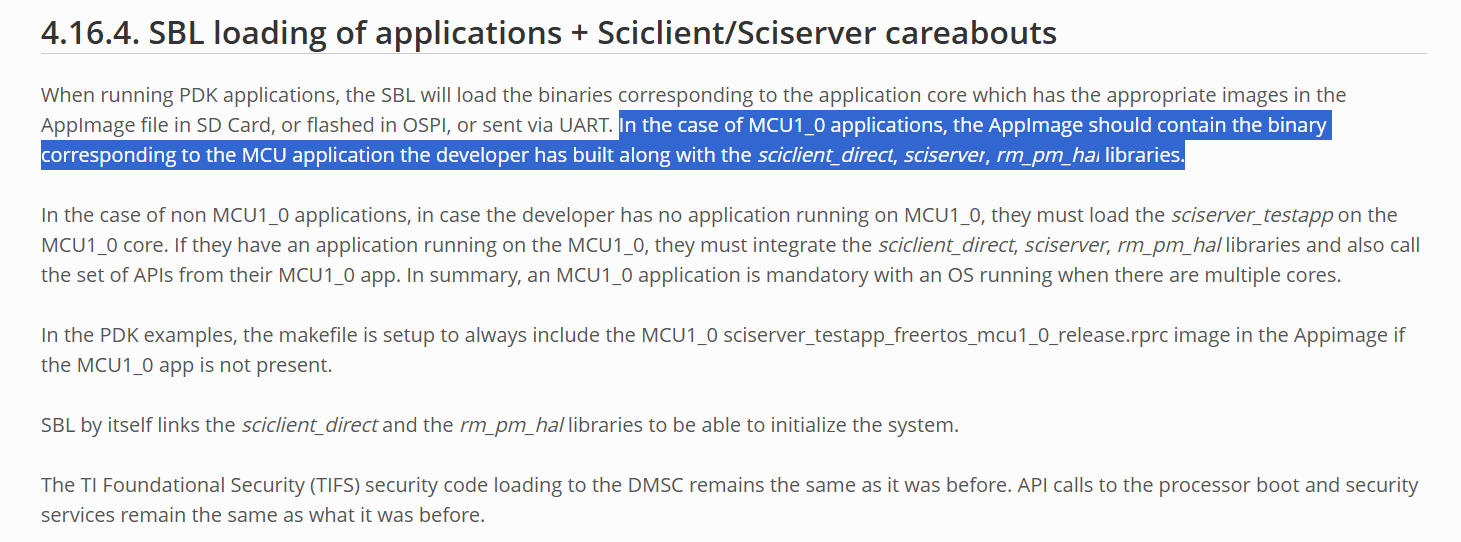

Hi Vishal,
It will depend on if you are running your application on MCU1_0 or not. However, the Sciserver application will be part of app image. Please take a look at the following image for information:
