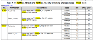

Can you help to provide the solution for AM6254 that how to configure the CPSW MAC TX delay, and how to configure the PHY RX delay, thanks.
Please note, the MAC TX delay is fixed to approximately 2ns and cannot be adjustable. It should meet the specs in the AM62x datasheet. You can check this depending on whether you are using RGMII or RMII mode.
