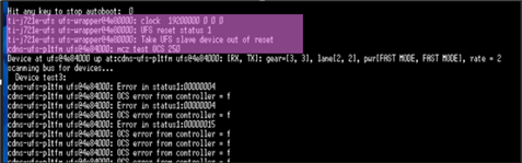

We use sdk 10.
UFS:KLUEGAJ1ZD-B0CQ059
In U-Boot, after entering ufs init and scsi scan, the following error sometimes occurs.

Device at ufs@4e84000 up at:cdns-ufs-pltfm ufs@4e84000: [RX, TX]: gear=[3, 3], lane[2, 2], pwr[FAST MODE, FAST MODE], rate = 2
scanning bus for devices...

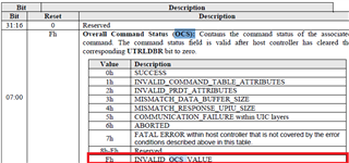

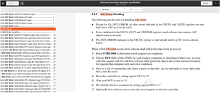

cdns-ufs-pltfm ufs@4e84000: Error in status:00000004
cdns-ufs-pltfm ufs@4e84000: OCS error from controller = f
cdns-ufs-pltfm ufs@4e84000: Error in status:00000014
cdns-ufs-pltfm ufs@4e84000: Error in status:00000015
Device 0: unknown device

    This is a probabilistic issue. By continuously restarting and entering commands, the reproduction probability is approximately one in several dozen attempts.

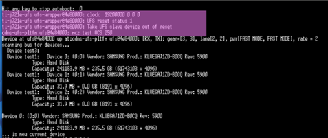

  • Hi Tanmay
    U-Boot SPL 2024.04 (May 01 2025 - 14:57:04 +0800)
    SYSFW ABI: 4.0 (firmware rev 0x000a '10.0.8--v10.00.08 (Fiery Fox)')
    Trying to boot from MMC2
    Warning: Detected image signing certificate on GP device. Skipping certificate to prevent boot failure. This will fail if the image was also encrypted
    Loading Environment from nowhere... OK
    Starting ATF on ARM64 core...
    NOTICE:  BL31: v2.10.0(release):v2.10.0-367-g00f1ec6b87-dirty
    NOTICE:  BL31: Built : 16:09:05, Feb  9 2024
    I/TC:
    I/TC: OP-TEE version: 4.2.0-dev (gcc version 13.3.0 (GCC)) #1 Fri Apr 12 09:51:21 UTC 2024 aarch64
    I/TC: WARNING: This OP-TEE configuration might be insecure!
    I/TC: WARNING: Please check https://optee.readthedocs.io/en/latest/architecture/porting_guidelines.html
    I/TC: Primary CPU initializing
    I/TC: GIC redistributor base address not provided
    I/TC: Assuming default GIC group status and modifier
    I/TC: SYSFW ABI: 4.0 (firmware rev 0x000a '10.0.8--v10.00.08 (Fiery Fox)')
    I/TC: HUK Initialized
    I/TC: Activated SA2UL device
    I/TC: Fixing SA2UL firewall owner for GP device
    I/TC: Enabled firewalls for SA2UL TRNG device
    I/TC: SA2UL TRNG initialized
    I/TC: SA2UL Drivers initialized
    I/TC: Primary CPU switching to normal world boot
    U-Boot SPL 2024.04 (May 01 2025 - 14:56:46 +0800)
    Detected: J7X-BASE-CPB rev E3
    Detected: J7X-VSC8514-ETH rev E2
    U-Boot 2024.04 (May 01 2025 - 14:56:46 +0800)
    SoC:   J721E SR1.1 GP
    Model: Texas Instruments J721e EVM
    Board: J721EX-PM2-SOM rev E8
    DRAM:  2 GiB (effective 4 GiB)
    Core:  116 devices, 34 uclasses, devicetree: separate
    Flash: 0 Bytes
    MMC:   mmc@4f80000: 0, mmc@4fb0000: 1
    In:    serial@2800000
    Out:   serial@2800000
    Err:   serial@2800000
    am65_cpsw_nuss ethernet@46000000: K3 CPSW: nuss_ver: 0x6BA00101 cpsw_ver: 0x6BA80100 ale_ver: 0x00293904 Ports:1
    Net:   Could not get PHY for mdio@f00: addr 0
    am65_cpsw_nuss_port ethernet@46000000port@1: phy_connect() failed
    No ethernet found.
    k3-navss-ringacc ringacc@2b800000: Ring Accelerator probed rings:286, gp-rings[96,20] sci-dev-id:235
    k3-navss-ringacc ringacc@2b800000: dma-ring-reset-quirk: disabled
    jedec_spi_nor flash@0: non-uniform erase sector maps are not supported yet.
    SF: Detected s28hs512t with page size 256 Bytes, erase size 256 KiB, total 64 MiB
    device 0 offset 0x680000, size 0x9
    SF: 9 bytes @ 0x680000 Read: OK
    The current system is on Partition A, set bootpart 0:1.
    Hit any key to stop autoboot:  0
      Device 0: (0:0) Vendor: SAMSUNG Prod.: KLUEGAJ1ZD-B0CQ Rev: 5900
                Type: Hard Disk
                Capacity: 241183.9 MB = 235.5 GB (61743103 x 4096)
      Device 1: (0:1) Vendor: SAMSUNG Prod.: KLUEGAJ1ZD-B0CQ Rev: 5900
                Type: Hard Disk
                Capacity: 31.9 MB = 0.0 GB (8191 x 4096)
      Device 2: (0:2) Vendor: SAMSUNG Prod.: KLUEGAJ1ZD-B0CQ Rev: 5900
                Type: Hard Disk
                Type: Hard Disk
    ... is now current device
    198 bytes read in 28 ms (6.8 KiB/s)
    Loaded env from uEnv.txt
    Importing environment from scsi 0:1 ...
    Running uenvcmd ...
    1420992 bytes read in 30 ms (45.2 MiB/s)
    Load Remote Processor 2 with data@addr=0x82000000 1420992 bytes: Success!
    322804 bytes read in 28 ms (11 MiB/s)
    Load Remote Processor 3 with data@addr=0x82000000 322804 bytes: Success!
    Failed to load '/lib/firmware/j7-main-r5f1_0-fw'
    Failed to load '/lib/firmware/j7-main-r5f1_1-fw'
    998192 bytes read in 28 ms (34 MiB/s)
    Load Remote Processor 6 with data@addr=0x82000000 998192 bytes: Success!
    998192 bytes read in 29 ms (32.8 MiB/s)
    Load Remote Processor 7 with data@addr=0x82000000 998192 bytes: Success!
    13504656 bytes read in 43 ms (299.5 MiB/s)
    Load Remote Processor 8 with data@addr=0x82000000 13504656 bytes: Success!
    20945408 bytes read in 60 ms (332.9 MiB/s)
    114126 bytes read in 27 ms (4 MiB/s)
    Working FDT set to 88000000
    1783 bytes read in 26 ms (66.4 KiB/s)
    11541 bytes read in 27 ms (417 KiB/s)
    ## Flattened Device Tree blob at 88000000
       Booting using the fdt blob at 0x88000000
    ERROR: reserving fdt memory region failed (addr=880000000 size=27000000 flags=4)
       Loading Device Tree to 000000008fee1000, end 000000008fffffff ... OK
    Working FDT set to 8fee1000
    Starting kernel ...

  • Hi, Tanmay

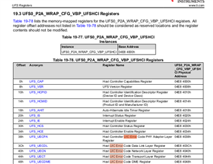

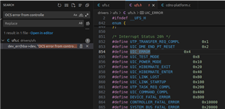

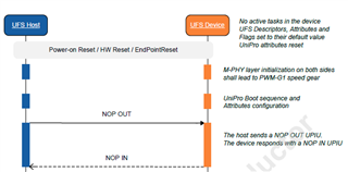

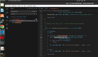

    Compare these two err logs, I found some thing strangeness.
    (1) What does the error mean? (Error: Invalid flag byte at 0x80000000. Value: 0xFF)
    (2) OCS return value is 0xF, so I try to study JEDEC 2223A UFS protocol description.
    I think this error should be happen in UFS flash early init stage, Do you have any debug suggestion?
    (3) Is it possible to decreases UFS R/W access speed for debugging?
    Wait your more suggestion

    ------>NO,NO,all boot in XSPI mode
    In XSPI boot mode, the error occurs randomly.

    (2) Hand shake checking for "NOP OUT(IN) UPIU"
    Because I suspect this "may be" an UFS flash POR issues, so I curius to know, how about check first hand shank message (NOP OUT(IN) UPIU)?
    Is it successful? you can stuff some debug message in u-boot
    Ref. https://blog.csdn.net/comeonbestxiaohe/article/details/88549918

    (3) UIC Error
    You can trace log, error code is "cdns-ufs-pltfm ufs@4e84000: Error in status:00000004"
    This is UIC error, we may need to study how UIC error happens.
    Some UIC error register in TRM,

    Update UFS boot failure issue where the system halts during U-Boot.
    White check mark Observations:
    1. Power and Signal Sequence Check
      We reviewed the timing of the following UFS-related signals:
      • UFS0_RSTN
      • UFS0_REF_CLK
      • VCC_3V3_UFS
      • VCC_1V8_UFS
      In the failure case, the waveforms show that UFS0_RSTN was not pulled LOW  during boot. This might indicate an issue with reset sequencing.
    2. Register Write Status Check
      The U-Boot log shows same behavior in UFS reset status=1 between success and failure:
      • fail
      • success
