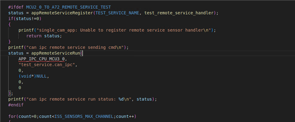

  • Hi Tarun,
    I tried registering the same service in mcu3_0 then after that I am sending first message from single cam app and it is getting received on mcu3_0 also.
    But when mcu3_0 is sending the message back to the app, I am getting the same issue "message received with no recipient".
    Below are the changes I am making:
    changes in single cam app:
    changes in mcu3_0/main.c:
    logs:
    regards,
