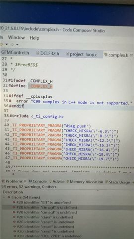

C2000 Complier report error for complex.h file as below, customer would like confirm if complier support C++? Any setting need to operation on CCS to enable C++?
Generally speaking, C++ is supported. For details, please search the C28x compiler manual for the sub-chapter titled Characteristics of TMS320C28x C++. Unfortunately, it fails to mention that Complex number arithmetic is supported only in C.
