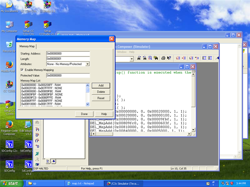

I am porting the Code Composer 4.10 development environment to another laptop. We use gel scripts to run tests using the TMSC3x simulator.  When the script runs it executes these gel commands:
memory()
{ GEL_MapOff( );
GEL_MapReset( );
GEL_MapOn( );
GEL_MapReset( );
GEL_MapAdd(0x00000000, 0, 0x00020000, 1, 1);
GEL_MapAdd(0x00020000, 0, 0x00000100, 1, 1);
GEL_MapAdd(0x00800000, 0, 0x00009fbf, 1, 1);
GEL_MapAdd(0x00809fc0, 0, 0x0000603f, 1, 1);
GEL_MapAdd(0x00810000, 0, 0x00008000, 1, 1);
GEL_MapAdd(0x00840000, 0, 0x0005000, 1, 1);
GEL_MapAdd(0x00850000, 0, 0x00000100, 1, 1);
GEL_MapAdd(0x00860000, 0, 0x0000ffff, 1, 1);
GEL_MapAdd(0x00870000, 0, 0x00000100, 1, 1);
GEL_MapAdd(0x00880000, 0, 0x00000100, 1, 1);
GEL_MapAdd(0x00890000, 0, 0x00000100, 1, 1);
A popup with error: Can't Add Memory Map.  Add Memory Map failed: Address: 0x800000, Length:0x9FBF Page0
followed by more 0x8500F4, 8500F5, 0x8500F8 and 0x8500FF.
I am using the brd file from the other laptop, same scripts and Code Composer.  Any help is greatly appreciated.
    What happens when you look at the debugger memory map? Does it look ok?
    I do see the message however. It seems to happen for a length greater than 0x2000 for that start address. I'm not sure if it some issue with the simulator or some other limitation. Please note that these tools are extremely old with completely unsupported. Hence we will not be able to provide much support here.
