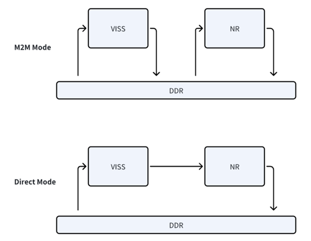

TDA4VE-Q1: VPAC support on the air operation
Part Number: TDA4VE-Q1
The current VPAC  Fvid2 drivers all prefixed with M2M, which means they only support memory to memory operations(if I am right). In some cases, we can direct connect two modules(like VISS and NR) by hard wire or local cache and bypass the DDR operations, which would consume less ddr bandwith and have lower end to end latency. I think the HTS(hardware thread scheduler) meant to do this? But the "HTS section" seems missing in the TRM. Is there an exmple to show how to  connect modules directly without using DDR(Direct Mode in the picture)?
