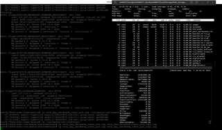

  • Hi
    IOMMU node was not added before the kernel panic.
    A kernel panic occured duriong the cp command test, so i added iommu.
    IOMMU doesn't seem to exist in tda4vh linux sdk, so I tried it with reference to ti other sdk.
    In addition, I found the following improvement method through workaround.
    Kernel panic occurs when buffer/cache memory is used more than about 8GB.
    So, this is a method to clean by setting the buffer/cache threshold(< 8GB) through monitoring App.
    I think we'll have to use this method until we find a solution.
    Dongho

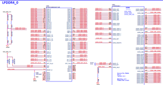

  • Hi Dongho,
    That is strange behavior that I have not seen before. The closest thing that I have observed in a past would be a memory leak leading to overloading the memory.
    So, I have 2 questions:
    • You mention in your first post "Made by New Board". Does this mean this is a custom board? And if yes, how much DDR is available on the board?
    • Has the memory map been changed?
    So far, I have not been able to reproduce the kernel panic on TI J784S4 EVM. I was using the 10.1 SDK instead of 9.2 SDK, so there are some differences, but I do not remember seeing kernel panic in 9.2 SDK so I assume behavior is same.
    Here is the information of the file I transferred from SD card to SSD card (it is 14GB SD card image I happened to have on my PC):

    Below is a screenshot of logs and some system information like "top" for CPU and running process info and "watch -n 1 cat /proc/meminfo" for monitoring the memory info:
    I used the "cp" command from commandline a couple of times, but it has not failed in all of my attempts.

  • Hi Takuma
    It is designed as a custom board and uses the same memory size as the EVM. The memory map has not been modified.
    If you continue to copy 2Gbyte files from nvme0 using the cp command, you can see that the "Cached" memory continues to increase.
     - file '2' size is 2Gbyte.
     1) root@j784s4-evm:/run/media/nvme0n1p1/dongho# cp 2 222
     2root@j784s4-evm:/run/media/nvme0n1p1/dongho# cp 2 333
    And when "Cached" exceeds about 8Gbyte, Kernel Panic occurs.
     - root@j784s4-evm:/run/media/nvme0n1p1/dongho# cp 2 444
    Please try to continuously copy files using the cp command inside the SSD to see if the "cached" size increases and there are no issues.

  • Hi Takuma, a new week is beginning.
    First at all the RAM design is the same as the EVM, LPDDR4(8G) x 4.
     - RAM Part Num : MT53E2G32D4DT-046
    If I can test DDR interleaving through memtester, I will do so and share it.
    Could you share how to use memtester? I think it needs to be run on uboot.

  • Hi Dongho,
    Could you create a new E2E forum post by clicking the "Ask a related question" button? And make the new post focused on memory instead of PCIe? This will route the new forum post to our memory experts within TI that will be able to help you out better.
    But from my limited knowledge with memory, there is a DDR config tool that is used to configure the DDR, and how to use this tool is in this application note: https://www.ti.com/lit/an/spracu8b/spracu8b.pdf?ts=1747054021791&ref_url=https%253A%252F%252Fwww.google.com%252F
    Perhaps there was a wrong configuration within the tool? Or, it could be hardware as you suspect. But in either case, it definitely looks to be an issue with DDR.
    Takuma
