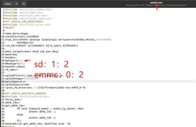

Hi Expert,
Customer just built their B1 sample board using the new version XAM62xB(SR1.1). And they feedback the board will boot fail, the log as attach, I want to double check with you, is there any change in boot rom? Any SW change need to be implement to B version AM62x?

  • Hi Biao,
    The boot log shows the issue doesn't seem to be in ROM.
    21099008 bytes read in 239 ms (84.2 MiB/s)
    59409 bytes read in 19 ms (3 MiB/s)
    Working FDT set to 88000000
    Bad Linux ARM64 Image magic!
    The log shows the kernel Image is loaded to DDR, but is not recognized.
    Is this boot from SDcard or eMMC?

  • Hi Biao,
    Please ask the customer to apply the following u-boot patch, rebuild u-boot, and update all the 3 u-boot binaries on the sdcard to see if it can boot into Linux.

  • Hi Bin,
    customer have tried this change, it will not work in new B1 board, they also tried on old board, it can work after this change.
    BR,
    Biao
  • Hi Biao,
    What is the content of file uEnv.txt on the sdcard? It should be empty in the SDK default.
    On both old passing board and new failure board, during boot when the U-Boot log shows
        Hit any key to stop autoboot:
    press any key to stop at the u-boot prompt, then run command  'print' and save its output to a file, and attach both files here. I'd like to see if there is any difference on both boards.
  • customer have tried this change, it will not work in new B1 board
    Is the error still the same as "Bad Linux ARM64 Image magic!" in line 73 in the log you attached in the first post?

  • Hi Bin,
    uENV.txt is empty. pls see below two outputs from different boards.

  • Thanks Biao. I will review the log tomorrow.
    Please ask the customer do another test, remove SBL, just use the purely Linux boot flow (using tiboot3.bin from U-Boot) on the failure board to see if the problem still happens.
  • Hi Bin,
    customer B1 board can boot now, I am checking with customer for the change, their bootmode pin setting have some issue, I think.
    BR,
    Biao
  • Hi Biao,
    Glad to hear the issue is resolved. Please do share the details of the resolution once you have it. Thanks.
  • Hi Bin,
    customer said they change the Bootpart in am62x.env file as below. change it from emmc to SD card, but I am confusing, why SR1.0 SOC can boot from SD card successfully even it is setting emmc Bootpart in env file?

  • Hi Biao,
    If bootpart has been modified to "0:2", it seems the board is booting from eMMC but not from the SD card. Do you know if the customer has flashed Linux to eMMC on this board?
