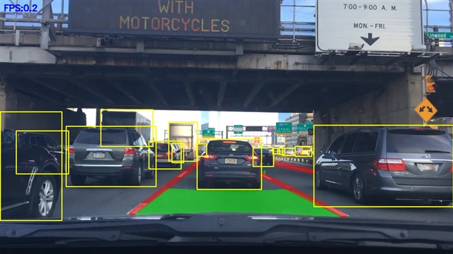

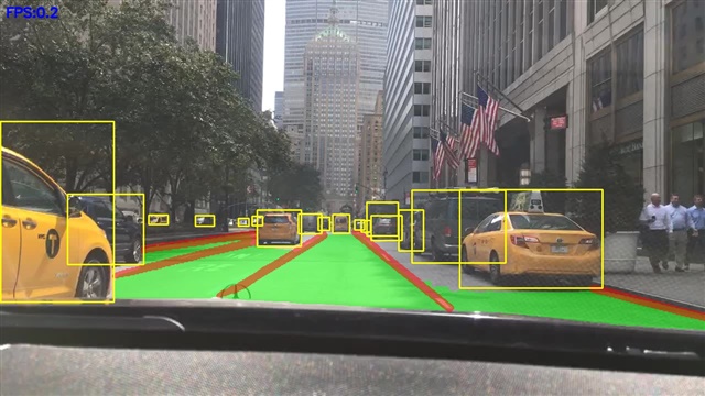

As per details provided in the thread https://e2e.ti.com/support/processors-group/processors/f/processors-forum/1493749/sk-tda4vm-yolopv2-lane-line-detection-distortion-when-off-loading-to-c7x/5802503#5802503 I am getting a fixed pattern output from the YOLOPv2 model compiled for the SK-TDA4VM.
Without offload
With offload
Without offload
 With offload
As suggested by , I tried using dynamic input dimensions when converting the model to ONNX from Pytorch, but the dynamic input model does not compile with any offloading for TIDL

    verbose logging in Docker on PC:
    root@2730038e794a:/home/root/yolopv2# python3 sample.py --source calib-imgs/ --name pcinfer --save --log 0
    compile_options: {'artifacts_folder': 'custom-artifacts/yolopv2', 'tidl_tools_path': '/home/root/tools/AM68PA/tidl_tools', 'advanced_options:c7x_firmware_version': '10_01_04_00'}

     The image with the result is saved in: runs/detect/pcinfer4/0023.jpg

     The image with the result is saved in: runs/detect/pcinfer4/d0639bd2-fcc27704.jpg
