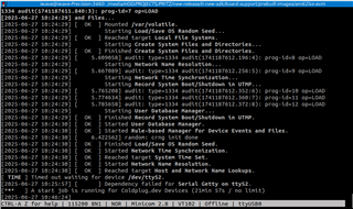

I was testing my board for power on and off test for 100 iterations.But due to some ttys2 it was failing.Kincly check the log shared here and help me debug it.
Why does that print comes only in some boots? (A start job is running for /dev/ttyS2 (23s / 1min 30s))

[*     ] (1 of 2) A start job is running for /dev/ttyS2 (5s / 1min 30s)
M[**    ] (1 of 2) A start job is running for /dev/ttyS2 (6s / 1min 30s)
M[***   ] (1 of 2) A start job is running for /dev/ttyS2 (6s / 1min 30s)
M[ ***  ] (2 of 2) A start job is running for…g All udev Devices (7s / no limit)
M[   ***] (2 of 2) A start job is running for…g All udev Devices (8s / no limit)
M[    **] (1 of 2) A start job is running for /dev/ttyS2 (9s / 1min 30s)
M[     *] (1 of 2) A start job is running for /dev/ttyS2 (9s / 1min 30s)
M[    **] (1 of 2) A start job is running for /dev/ttyS2 (10s / 1min 30s)
M[   ***] (2 of 2) A start job is running for… All udev Devices (10s / no limit)
M[  *** ] (2 of 2) A start job is running for… All udev Devices (11s / no limit)
M[ ***  ] (2 of 2) A start job is running for… All udev Devices (12s / no limit)
M[***   ] (1 of 2) A start job is running for /dev/ttyS2 (12s / 1min 30s)
M[**    ] (1 of 2) A start job is running for /dev/ttyS2 (13s / 1min 30s)
M[*     ] (1 of 2) A start job is running for /dev/ttyS2 (13s / 1min 30s)
M[**    ] (2 of 2) A start job is running for… All udev Devices (14s / no limit)
M[***   ] (2 of 2) A start job is running for… All udev Devices (14s / no limit)
M[ ***  ] (2 of 2) A start job is running for… All udev Devices (15s / no limit)
M[  *** ] (1 of 2) A start job is running for /dev/ttyS2 (16s / 1min 30s)
M[   ***] (1 of 2) A start job is running for /dev/ttyS2 (16s / 1min 30s)
M[    **] (1 of 2) A start job is running for /dev/ttyS2 (17s / 1min 30s)
M[     *] (2 of 2) A start job is running for… All udev Devices (17s / no limit)
M[    **] (2 of 2) A start job is running for… All udev Devices (18s / no limit)
M[   ***] (2 of 2) A start job is running for… All udev Devices (19s / no limit)
M[  *** ] (1 of 2) A start job is running for /dev/ttyS2 (19s / 1min 30s)
M[ ***  ] (1 of 2) A start job is running for /dev/ttyS2 (20s / 1min 30s)
M[***   ] (1 of 2) A start job is running for /dev/ttyS2 (20s / 1min 30s)
M[**    ] (2 of 2) A start job is running for… All udev Devices (21s / no limit)
M[*     ] (2 of 2) A start job is running for… All udev Devices (21s / no limit)
M[**    ] (2 of 2) A start job is running for… All udev Devices (22s / no limit)
M[***   ] (1 of 2) A start job is running for /dev/ttyS2 (23s / 1min 30s)
M[ ***  ] (1 of 2) A start job is running for /dev/ttyS2 (23s / 1min 30s)
M[  *** ] (1 of 2) A start job is running for /dev/ttyS2 (24s / 1min 30s)
M[   ***] (2 of 2) A start job is running for… All udev Devices (24s / no limit)
M[    **] (2 of 2) A start job is running for… All udev Devices (25s / no limit)
M[     *] (2 of 2) A start job is running for… All udev Devices (26s / no limit)

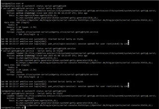

  • Hi Dheeraj,
    When you boot into Linux on your board, what is the output of command 'systemctl status getty@ttyS2'?
    The EVM shows it is "disabled" in the SDK v11.0.5.2.
    root@am62lxx-evm:~# uname -a
    Linux am62lxx-evm 6.12.13-ti-g1a2d611ee02d #1 SMP PREEMPT Wed Feb 26 17:29:25 UTC 2025 aarch64 GNU/Linux
    root@am62lxx-evm:~# systemctl status getty@ttyS2
    * getty@ttyS2.service - Getty on ttyS2
         Loaded: loaded (8;;file://am62lxx-evm/usr/lib/systemd/system/getty@.service/usr/lib/systemd/system/getty@.service8;;; disabled; preset: enabled)8;;
         Active: inactive (dead)
           Docs: 8;;man:agetty(8)man:agetty(8)8;;8;;

  • Yes , In EVM The debug uart is not configured to ttyS2 .It is ttyS0 , and that is service active and running . But In my custom board my debug uart is configured to ttyS2.
  • Yes the EVM uses ttyS0 as the Linux console, but getty@ttyS0 is disabled too.
    root@am62lxx-evm:~# cat /proc/cmdline
    console=ttyS0,115200n8 vt.global_cursor_default=0 earlycon=ns16550a,mmio32,0x02800000 root=PARTUUID=076c4a2a-02 rw rootfstype=ext4 rootwait
    root@am62lxx-evm:~# systemctl status getty@ttyS0
    * getty@ttyS0.service - Getty on ttyS0
                 8;;man:systemd-getty-generator(8)man:systemd-getty-generator(8)8;;8;;
                 8;;https://0pointer.de/blog/projects/serial-console.htmlhttps://0pointer.de/blog/projects/serial-console.html8;;8;;

  • Hi ,
    The ttys0 status in my board is coming as Active:running .  I have not modified anything directly copied the wic file and booted .I'm  using the sdk verison
    11.00.05.02 (Mar 4, 2025) .
  • Please use systemctl command to disable it to see if you still have boot failure issue.
  • Wait a sec, you are looking at serial-getty service, but I was checking getty service. I will check what serial-getty is tomorrow.
  • Is there any way to disable that service while generating the wic file itself through yocto compilation . I need to test SW-rebooot for overnight with the binaries generated from yocto(not allowed to change anything like disbaling a service)?
  • I was checking serial getty because , The error was like dependecy failed  on serial getty ttys2.
  • serial-getty@ttyS2 service shouldn't be disabled, it is related to the uart console login.
    In your kernel log:
    [    0.000000] Kernel command line: console=ttyS2,115200n8 earlycon=ns16550a,mmio32,0x02800000 root=PARTUUID=076c4a2a-02 rw rootfstype=ext4 rootwait
    [    3.226334] 2800000.serial: ttyS2 at MMIO 0x2800000 (irq = 195, base_baud = 3000000) is a 8250
    You still uses the same console uart 0x2800000 as that on the evm, why do you change its alias to ttyS2?
  • I have used other uart for rs232 ,rs485 .So could that be the issue. I wil check by modifying the console alias name to ttyS0(serial0)
  • Hi ,
    I tried modifying the aliases but still the issue persists. along with one more job service like All Udev services
  • Hi Bin,
    After waiting for some time , i could see like this.
