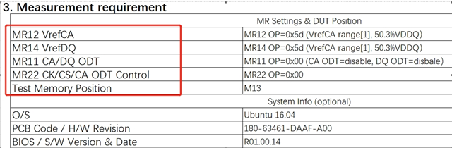

Hi James,
customer want to let micron help to do the simulation of LPDDR4, Micron need they provide below parameter: MR11 MR12 MR13 MR14 MR22
I let customer follow below link to read it, but it can't work on AM62A. so I need you help to provide the way to get those value.

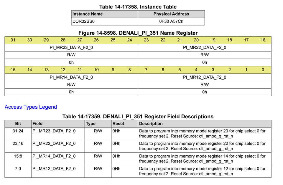

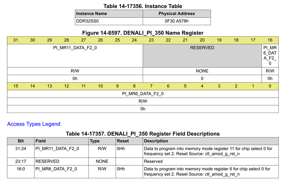

  • Biao, you can read these in the following registers for the operating frequency.  There is a value for each byte.  Note that MR12/MR14 are trained values.
    DENALI_PI_350 0x0F30A578 PI_MR11_DATA_F2_0
    DENALI_PI_351 0x0F30A57C PI_MR12_DATA_F2_0
    DENALI_PI_351 0x0F30A57C PI_MR14_DATA_F2_0
    DENALI_PI_351 0x0F30A57C PI_MR22_DATA_F2_0
    DENALI_PI_374 0x0F30A5D8 PI_MR11_DATA_F2_1

  • Hi,James
         Regarding your previous answer, I have a question: According to Micron's reference values for MR11 and MR12, these should be 1-byte in size, but your reply mentioned a 4-byte value. Is that correct?
    Below are the register values I read out. Could you clarify what the corresponding values for MR11, MR12, MR14, and MR24 are?

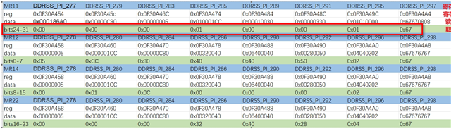

    root@am62axx-evm:/opt/edgeai-gst-apps# devmem2 0x0F30A578
    Read at address  0x0F30A578 (0xffff90ee1578): 0x55000000
    root@am62axx-evm:/opt/edgeai-gst-apps# devmem2 0x0F30A57c
    Read at address  0x0F30A57C (0xffffa890b57c): 0x20162011
    root@am62axx-evm:/opt/edgeai-gst-apps# devmem2 0x0F30A5d8
    Read at address  0x0F30A5D8 (0xffff8eacd5d8): 0x55000000
    root@am62axx-evm:/opt/edgeai-gst-apps# devmem2 0x0F30A5dc
    Read at address  0x0F30A5DC (0xffff9b54e5dc): 0x20162B27
    root@am62axx-evm:/opt/edgeai-gst-apps# devmem2 0x0F30A638
    Read at address  0x0F30A638 (0xffff94126638): 0x55000000
    root@am62axx-evm:/opt/edgeai-gst-apps# devmem2 0x0F30A63c
    Read at address  0x0F30A63C (0xffff9ca5463c): 0x20162412
    root@am62axx-evm:/opt/edgeai-gst-apps# devmem2 0x0F30A698
    Read at address  0x0F30A698 (0xffff9f50a698): 0x55000000
    root@am62axx-evm:/opt/edgeai-gst-apps# devmem2 0x0F30A69c
    Read at address  0x0F30A69C (0xffff9173269c): 0x20162B27
    Yang
  • Yes, please use the TRM to extract the appropriate bit fields:
