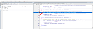

I transplanted the bist demo in SDL to run in my mcu10, but when the instance was C7X, DataAbortException was triggered,the sdk is "ti-processor-sdk-rtos-j721s2-evm-08_06_01_03"

Are you testing using the standalone SDL bist_example? Could you please share your output logs and more details on your boot flow?

In SDK 9.1 and onwards, the MCU R5 can modify the CLEC, as updated SYSFW image is allowing for this. The MCU R5 can then program the CLEC as it wants, whether it be for A72 / C7x / ANA and you would not have to use the sciclient_clear_clec_secure_claim_c7x_1_release binary.

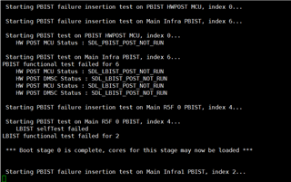

This is my latest log status. The lbist not running,What causes this problem?
Please refer to the following FAQ - (+) [FAQ] TDA4VM: SDL BIST Example Application Failing on SDK 8.6 - Processors forum - Processors - TI E2E support forums
