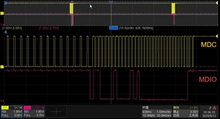

我们使用 TDA4VM SDK 10.0,希望启用 CPSW2G 以太网在 Uboot 中实现 TFTP。
我修改了设备树。

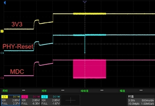

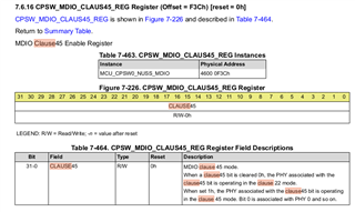

在进入 phy_find_by_mask() 函数之前,我确认了 phy 芯片的电源是正确的,并且还进行了硬件重置。PHY 地址为 2。
但我找不到我的 phy。如何调试它?
设备树和日志在此处提供:
board-support/ti-u-boot-2024.04+git/arch/arm/dts/k3-j721e-common-proc-board.dts

am65_cpsw_nuss ethernet@46000000: K3 CPSW: nuss_ver: 0x6BA00101 cpsw_ver: 0x6BA80100 ale_ver: 0x00293904 Po:1
Detected: J7X-BASE-CPB rev E3
Detected: J7X-VSC8514-ETH rev E2
Net:   CONFIG_PHY_FIXED
phy_find_by_mask() Enter .
mdio@f00 PHY: 2 not found
Could not get PHY for mdio@f00: addr 2
am65_cpsw_nuss_port ethernet@46000000port@1: phy_connect() failed
No ethernet found.
k3-navss-ringacc ringacc@2b800000: Ring Accelerator probed rings:286, gp-rings[96,20] sci-dev-id:235
k3-navss-ringacc ringacc@2b800000: dma-ring-reset-quirk: disabled
jedec_spi_nor flash@0: non-uniform erase sector maps are not supported yet.
SF: Detected s28hs512t with page size 256 Bytes, erase size 256 KiB, total 64 MiB
device 0 offset 0x680000, size 0x9
SF: 9 bytes @ 0x680000 Read: OK
Error: Invalid partition value at 0x80000000. Value: 0xFF
Error: Invalid flag byte at 0x80000000. Value: 0xFF
Hit any key to stop autoboot:  0
=> mdio list
mdio@f00:
=> net list
CONFIG_PHY_FIXED
am65_cpsw_nuss_port ethernet@46000000ethernet@46000: phy_connect() failed
CONFIG_PHY_FIXED
eth0 : ethernet@46000000ethernet@46000 00:00:00:00:00:00
=> mii info
PHY 0x00: OUI = 0x0000, Model = 0x00, Rev = 0x00,  10baseT, HDX
PHY 0x02: OUI = 0x0000, Model = 0x00, Rev = 0x00,  10baseT, HDX
=> mii device
MII devices: 'mdio@f00'
Current device: 'mdio@f00'

    After measuring the waveform of MDC during uboot, it was found that the bus remained at a high level when idle. Could it be that the uboot mdio bus was not initialized?
    Can you confirm that the phy is out of reset by probing the phy reset line.
    Tanmay

    I extended the waiting time here to 1000ms and completed the reset for the phy chip within this 1000ms.
    The waveform is captured when powered on. It can be seen that within this 1000ms MDC working time,
    the phy chip has completed the reset, but the phy cannot be detected.
    "mdio@f00 PHY: 2 not found
    am65_cpsw_nuss_port ethernet@46000000ethernet@46000: phy_connect() failed"

    => mdio read mdio@f00 2 2
    Reading from bus mdio@f00
    PHY at address 2:
    2 - 0x0
    It can be seen that I read the Identifier Register of the phy using the command 'mdio read mdio@f00 2 2', which is 0.
    This is the corresponding waveform diagram. How to continue debugging?
  • Are there any updates?
    The weird thing is the we are not reading at phy address 2 in the get_phy_id function when the reg is 2 in the device tree. Have you made any changes to u-boot souces?

  • Hi, zs
    As far as I know, 88Q2220 only support C45 protocol, isn't?
    You need to double check your vendor.
    If the answer is "yes", make sure you enable C45 protocol in u-boot w/ CPSW2G
    Example,
    https://e2e.ti.com/support/processors-group/processors/f/processors-forum/1451214/c45-phy-support-on-am62a
    https://e2e.ti.com/support/processors-group/processors/f/processors-forum/1020179/tda4vm-how-to-configure-a-mdio-phy-address-is-clause-45-c45-access/3771464?tisearch=e2e-sitesearch&keymatch=tda4%20c45#3771464

    Hi, Tanmay
    I guess it could be "C22" or "C45" protocol issues.
    Could we have any register to check C45 enable in CPSW2G?
    Ref,
    https://e2e.ti.com/support/processors-group/processors/f/processors-forum/1184774/tda4vm-cpsw2g-c45-phy-support
    Thank You Very Much
    Gibbs
  • I solved this problem by simulating c45 with c22. This ticket can be closed. Thank you for your support.
