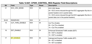

  • Hi Xiulin,
    iet_rx_smd_err: 140
    Looking up the details of this statistic in the TRM, it seems like this is related to IET (Interspersed Express Traffic). Are you setting up some sort of IET configuration?
    Additionally, is IET_ENABLE set in your test environment?
      1. How to solve CRC error? Because this issue only appeared after one day of operation of iperf3 at a high temperature of 85 degrees Celsius.
    Are you seeing the rx_crc_error counter incrementing when this happens? When applying the high temperature, was it applied on your entire custom board or just the AM620 processor? To my knowledge, the AM62x processor should have passed CPSW iperf functional testing up a temperature of 100 degrees Celsius, so perhaps there is a component on your board (maybe your Ethernet PHY?) that might not be functioning properly at 85 degrees C? While I cannot comment on the PHY chip rtl9010 since it's not a TI part, it might be worth checking if you can read any registers from this PHY indicating that packets are being transmitted and received.
    When I tried not to enable the PHY chip rtl9010 register 0xd04a bit2 (RGMIIRXC_timing, add 2ns delay for rxc latching RXD), the phenomenon was the same as this, tcpdump could only capture the sent packets and could not capture the received ones.
    Please note, the goal is to introduce the 2ns delay to create an offset between the clock and data lines (if this wasn't done already) and this is usually the main reason for RX CRC errors.
    -Daolin

  • Hi Xiulin,
        1. Are you setting up some sort of IET configuration?
        --> I didn't set this up, does the platform default enable it? How to open it? How to close it? How to check if it is open?
    My initial thought was if you can check if IET_ENABLE is set in your test environment (please don't make any changes, just check what it is currently configured as). As I showed in the screenshot it looks like the IET_ENABLE bit is in the CPSW_CONTROL_REG register at register address 00020004h. You can do "devmem2 0x00020004" to read the contents of the register and check if what is the IET_ENABLE bit configured as.
        1. The entire board is placed inside the high-temperature chamber.
    Is there a possibility that there is another component on the board that is failing at high-temperatures? Like I mentioned before, perhaps checking the PHY registers to ensure the PHY is working properly. Is this related to https://e2e.ti.com/support/processors-group/processors/f/processors-forum/1506023/am620-q1-am620-q1-high-temperature-85-degrees-celsius-eth-iperf-test-eth-driver-crash-issue ?
    -Daolin
