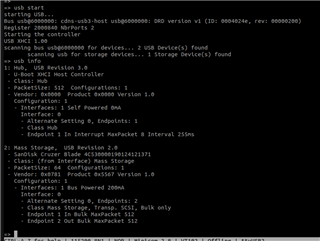

=> usb start
starting USB...
No working controllers found

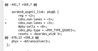

  • Hi Alvin,
    Can you mention the changes you have made to try enabling the USB 3.0 in UBOOT ?
    Gokul
  • // SPDX-License-Identifier: GPL-2.0

  • From d9a2524868a8b9680ade616ae2f0b830f2c03166 Mon Sep 17 00:00:00 2001
    From: "alvinyc.chen.moxa" <AlvinYC_Chen@moxa.com>
    Date: Thu, 8 May 2025 14:40:55 +0800
    Subject: [PATCH] EVM modify
     arch/arm/dts/k3-j7200-common-proc-board.dts | 187 ++++++++++++++++----
     arch/arm/dts/k3-j7200-main.dtsi             |   3 +-
     arch/arm/dts/k3-j7200-som-p0.dtsi           |  50 +-----

     &usb0 {
    -	dr_mode = "otg";
    +	dr_mode = "host";
     	maximum-speed = "high-speed";
    @@ -441,7 +569,7 @@
     	serdes0_qsgmii_link: phy@1 {
     		reg = <2>;
    -		cdns,num-lanes = <1>;
    +		cdns,num-lanes = <3>;
     		#phy-cells = <0>;
     		cdns,phy-type = <PHY_TYPE_QSGMII>;
     		resets = <&serdes_wiz0 3>;

  • Hi Alvin,
    U-BOOT changes:
    • Can you remove the below changes of u-boot dts that you had made and instead add the changes below for u-boot dts which is attached in the below file and provide the logs of usb start on UBOOT .
    Changes to remove:
    Changes to add:
    https://e2e.ti.com/cfs-file/__key/communityserver-discussions-components-files/791/usb3_5F00_0.patch
    • Please make sure that your DP switch follow the configuration as
      • switch 3.3  =0 and switch 3.4=0.
    DP switch reference image .
    https://software-dl.ti.com/jacinto7/esd/processor-sdk-rtos-jacinto7/latest/exports/docs/psdk_rtos/docs/user_guide/evm_setup_j721e.html#ospi-boot-mode-j721e-es1-x-versions-only
    Once these are done,boot into Uboot and try the usb start command.
    Gokul

    @@ -183,7 +183,7 @@
     &usbss0 {
     	bootph-all;
    -	ti,usb2-only;
    +	/delete-property/ ti,usb2-only;
     &usb0 {
    diff --git a/arch/arm/dts/k3-j7200-common-proc-board.dts b/arch/arm/dts/k3-j7200-common-proc-board.dts
    index 068faaaf..bca1e27f 100644
    --- a/arch/arm/dts/k3-j7200-common-proc-board.dts
    +++ b/arch/arm/dts/k3-j7200-common-proc-board.dts
    @@ -325,13 +325,14 @@
     &davinci_mdio {
     	phy0: ethernet-phy@0 {
     		reg = <0>;
    -		ti,rx-internal-delay = <DP83867_RGMIIDCTL_2_00_NS>;
    +		ti,rx-internal-delay = <DP83867_RGMIIDCTL_2_25_NS>;
    +		ti,tx-internal-delay = <DP83867_RGMIIDCTL_2_25_NS>;
     		ti,fifo-depth = <DP83867_PHYCR_FIFO_DEPTH_4_B_NIB>;
     &cpsw_port1 {
    -	phy-mode = "rgmii-rxid";
    +	phy-mode = "rgmii-id";
     	phy-handle = <&phy0>;
    @@ -356,6 +357,24 @@
    +&exp1 {
    +	p15-hog {
    +		/* P15 - EXP_MUX2 */
    +		gpio-hog;
    +		gpios = <13 GPIO_ACTIVE_HIGH>;
    +		output-high;
    +		line-name = "EXP_MUX2";
    +	p16-hog {
    +		/* P16 - EXP_MUX3 */
    +		gpio-hog;
    +		gpios = <14 GPIO_ACTIVE_HIGH>;
    +		output-high;
    +		line-name = "EXP_MUX3";
      * The j7200 CPB board is identical to the CPB used for J721E, the SOMs can be
      * swapped on the CPB.
    @@ -401,7 +420,7 @@
     &serdes_ln_ctrl {
     	idle-states = <J7200_SERDES0_LANE0_PCIE1_LANE0>, <J7200_SERDES0_LANE1_PCIE1_LANE1>,
    -		      <J7200_SERDES0_LANE2_QSGMII_LANE1>, <J7200_SERDES0_LANE3_IP4_UNUSED>;
    +	<J7200_SERDES0_LANE2_IP3_UNUSED>, <J7200_SERDES0_LANE3_USB>;
     &usb_serdes_mux {
    @@ -412,12 +431,14 @@
     	pinctrl-names = "default";
     	pinctrl-0 = <&main_usbss0_pins_default>;
     	ti,vbus-divider;
    -	ti,usb2-only;
     &usb0 {
    -	dr_mode = "otg";
    -	maximum-speed = "high-speed";
    +	dr_mode = "host";
    +	maximum-speed = "super-speed";
    +	phys = <&serdes0_usb_link>;
    +	phy-names = "cdns3,usb3-phy";
     &tscadc0 {
    @@ -431,29 +452,18 @@
     &serdes0 {
    -	serdes0_pcie_link: phy@0 {
    -		reg = <0>;
    -		cdns,num-lanes = <2>;
    -		#phy-cells = <0>;
    -		cdns,phy-type = <PHY_TYPE_PCIE>;
    -		resets = <&serdes_wiz0 1>, <&serdes_wiz0 2>;
    -	serdes0_qsgmii_link: phy@1 {
    -		reg = <2>;
    +	status = "okay";
    +	serdes0_usb_link: phy@2 {
    +		reg = <3>;
     		#phy-cells = <0>;
    -		cdns,phy-type = <PHY_TYPE_QSGMII>;
    -		resets = <&serdes_wiz0 3>;
    +		cdns,phy-type = <PHY_TYPE_USB3>;
    +		resets = <&serdes_wiz0 4>;
     &pcie1_rc {
    -	status = "okay";
    -	reset-gpios = <&exp1 2 GPIO_ACTIVE_HIGH>;
    -	phys = <&serdes0_pcie_link>;
    -	phy-names = "pcie-phy";
    -	num-lanes = <2>;
    +	status = "disabled";
     &mcu_mcan0 {

    Can you try applying the below patch as after applying the same we were able to detect the USB 2.0 device.
    https://e2e.ti.com/cfs-file/__key/communityserver-discussions-components-files/791/0001_2D00_Enable_2D00_USB2.0_2D00_in_2D00_U_2D00_BOOT.patch
    Logs:
    Gokul
