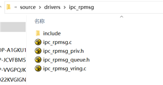

    The library files I shared are for the real-time core. When the real-time core receives messages from the non-real-time core, it frequently disables and re-enables interrupts within the interrupt handler. If message sending occurs too frequently, this may cause other interrupts in the real-time core to be lost.Can we use polling instead of interrupt-driven methods for message reception? If so, could you provide relevant implementation examples?
    C:\ti\mcu_plus_sdk_am64x_08_06_00_43\source\drivers\ipc_rpmsg

    Are you referring to HwiP_disable()? If not, can you please point me to which portions of the code are you referring to?
    As a background, IPC RPmsg underneath uses IPC Notify, which in turns uses Interrupt HW mechanisms to interrupt the receiving cores. Changing IPC RPmsg to polling will require a complete re-work in my mind.
