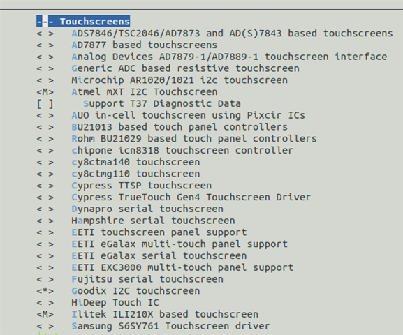

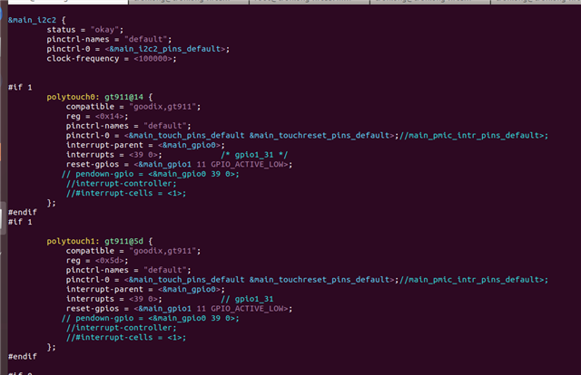

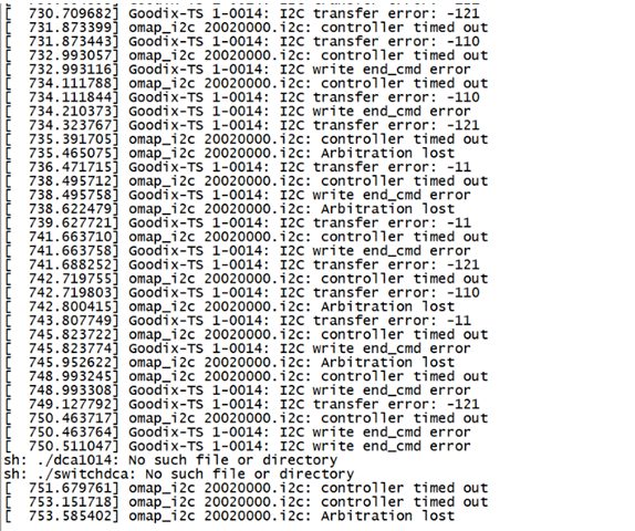

I used the version ti-processor-sdk-linux-rt-am62xx-evm-08.06.00.42 and connected the GT911 touchscreen. The device tree configuration was as follows, but the following problem kept occurring, eventually causing the system to crash and preventing login through the network port. Could you please tell me what the problem was?After the occurrence of "Arbitration lost", the system completely crashed
