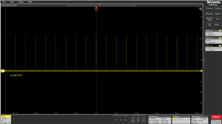

Using the code snippet below, we are trying to generate pulse on MCU-GPIO Pin with 13us ON-Time and 10ms period. We added this logic in one task from where it is generate keep-alive pulse of 13us on GPIO-Pin in particular condition.

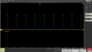

During testing we found that after Reboot randomly observed that 956us ON-Period generate even though we have configured 13us (hard-core value) in ClockP_usleep() function.
Does ClockP_usleep() function stable/working for small microseconds values configuration or not? Kindly provide solution on above issue.
Any additional configuration require to before use ClockP_usleep() function ? Please provide details on it also.
Normal-Pulse:-  (Configure 13us sleep  (using ClockP_usleep)  and getting pulse width 13.89 us)
Higher ON-Time Pulse (Issue randomly observed)   (Configure 13us sleep  (using ClockP_usleep)  and getting randomly pulse width 956.3 us)
    Does this means that GPIO signal was high for 956 us instead of 13us? How many times this issue occurs?
    Yes,  GPIO high for the around 956us instead of the 13us even though hardcore value set 13us in ClockP_usleep() function for keep-alive.
    In Soft-Reboot;  Observed this issue around 3 times; when check 5 times.
    In HW-Reboot;  Observed this issue around 4 times; when check 10 times.
