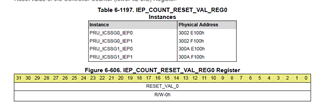

This can be explained by looking at the way the IEP is generating the internal 1ms cycle from the 333MHz clock with these register settings:
0x00 IEP_GLOBAL_CFG_REG: 0x00000331 == 3ns increment per 333MHz clock cycle (no compensation per default)
0x7c IEP_CMP0_REG1: 0x000f423d == 999,997ns
Clock cycle 0: 0 cycles, 0ns
Clock cycle 1: 0 cycles, 3ns
Clock cycle 333,332: 0 cycles, 999,996ns
Clock cycle 333,333: 0 cycles, 999,999ns <- since 999,999ns >= 999,997ns (CMP0) the counter is reset at the next clock edge
Clock cycle 333,334: 1 cycles, 0ns <- the IEP has "added" 1ns instead of 3ns -> we are losing 2ns per 1ms cycle -> 2,000ppb
Q: Is this the intended behavior for the IEP? 1ms in the IEP clock domain does not really equal 1ms in "real time", it's only 999,998 ns long.
Q: Shouldn't the firmware take care of compensating this by setting a 2,000ppb frequency offset in the IEP compensation registers by default?
Q: Must the IEP run at the same clock speed as the prueth-firmware (333MHz)? If the IEP could run at 200MHz or 250MHz this would not be a problem.
    I'm checking internally with the ICSS team to see if the firmware should be compensating for the 2000ppb freq offset and if this behavior is intended. From an initial test of phc2sys (even on SDK 10.01), I also see there is ~2000ppb offset.
    It looks like from the AM64x EVM (TMDS64EVM) device tree ("k3-am64-main.dtsi"), the IEP clock is sourced from the same clock as the ICSSG core clock ("ICSSGn_CORE_CLK), which is 333MHz. Based on the TRM, the IEP clock can alternatively be sourced from a separate clock source ("ICSSGn_IEP_CLK"). It may be possible to change the clock source of the IEP clock to a different clock in the device tree. Try applying similar changes as described in https://e2e.ti.com/support/processors-group/processors/f/processors-forum/1049800/faq-pru_icssg-how-to-check-and-set-pru-core-frequency-in-linux/3959698?tisearch=e2e-sitesearch&keymatch=IEP%252525252520333MHz#3959698, but making sure to apply on the "icssg0_iepclk_mux" node.
    Also, why is it 999,998ns as opposed to 999,999,999ns as you explained in your calculation for the 333,333 clock cycle?

  • The problem occurs from 333,333th clock cycle to 333,334th clock cycle. At that point the counter should read 1,000,000,002ns, but it only reads "1 cycle + 0ns", so 1,000,000,000ns, thus loosing 2ns.
    We would like to understand if there are any concerns regarding the firmware's use of the ICSS-G / IEP if we clocked the IEP asynchronously to the rest of the ICSS-G. Hardware-wise this is possible, and I'm pretty sure it can be configured (or adapted to being configurable), but there could be caveats regarding asynchronous clocks that we don't understand
    Hi Dominic
    For this issue, can you try configuring IEP_COUNT_RESET_VAL_REG0 to 2
    Pratheesh
  • Hello Pratheesh,
    thanks for your comment. I'm not sure this would solve the 1st issue:
    On the first cycle it would work: 0...3...6...999999...2
    On the second and subsequent cycles, I believe we would be 1 ns too long: 2...5...8...999998...2
    That's basically the same thing as the 3rd issue: you run into problems when you have non-integer multiples of the base (IEP frequency vs. cycle time, cycle time vs. PPS period), and this can't be solved with a static configuration.
    Dominic Rath
