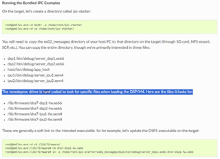

    by any chance, are you linking your firmware to the hard-coded name that the SW expects as mentioned in the Documentation?
    Could you please upload a step by step description of your procedure?
    -Josue
  • I linked and loaded the file that built the ex02_messageq example under the /lib/firmware directory, but I got a crash error.
    ln -sf /root/ipc-starter/ex02_messageq/server_dsp1.xe66 /lib/firmware/dra7-dsp1-fw.xe66
