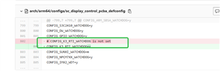

AM623: The RTI-Windowed Watchdog Timer (WWDT) function is not working on the HS-SE hardware.
Part Number: AM623
The WWDT function has issues on the HS-SE board, while it works properly on the HS-FS board. The verification method is as follows: Add logic to the watchdog - feeding function to feed the watchdog only twice. When verified on the non - fuse board, the system will trigger a watchdog restart after two times of feeding. However, on the fuse board, the restart will not be triggered.
drivers/watchdog/rti_wdt.c
static int count = 2 ;
static int rti_wdt_ping(struct watchdog_device *wdd)
	struct rti_wdt_device *wdt = watchdog_get_drvdata(wdd);
	printk("enter %s, count=%d\n", __func__, count);
	if(count-- <= 0)
		return 0;
	/* put watchdog in service state */
	writel_relaxed(WDKEY_SEQ0, wdt->base + RTIWDKEY);
	/* put watchdog in active state */
	writel_relaxed(WDKEY_SEQ1, wdt->base + RTIWDKEY);
	printk("leave %s, count=%d\n", __func__, count);
	return 0;

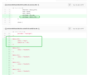

  • Hi , Nick,
    1 > HS-FS: High Security - Field Securable  ; HS-SE : High Security - Security Enforced; there is no other differences .
    2> The version of Linux SDK is 10_01_10_04.
    3> The non-signed version runs on HS-FS, while the signed version runs on HS-SE. This is because the HS-SE board cannot run non-signed versions. Other than that, there are no differences in the software.
    4> We compared the watchdog registers between the HS and HS-FS firmware versions, and found that all register values are exactly the same.

  • Hi, Nick,
         I can confirm without a doubt that the circuit boards are exactly the same and the code is exactly the same (except that one of the codes is signed). Yes, this is a very strange issue. Or could TI colleagues reproduce the phenomenon using HS-SE and HS-FS?

        Please configure the device tree and defconfig according to the settings in the green box. The hw_wdg is an external hardware watchdog. If it is not available on your board, you can skip the configuration. If main_rti0 is used as watchdog0, then the command for feeding the watchdog: "watchdog -T 30 -t 15 /dev/watchdog1 -F" needs to be changed to "watchdog -T 30 -t 15 /dev/watchdog0 -F".
