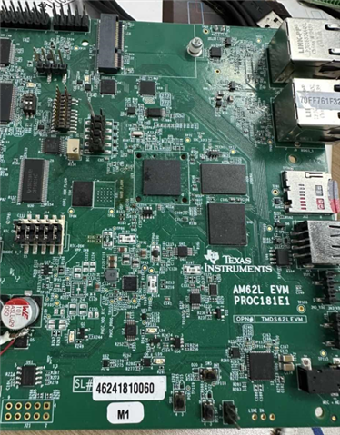

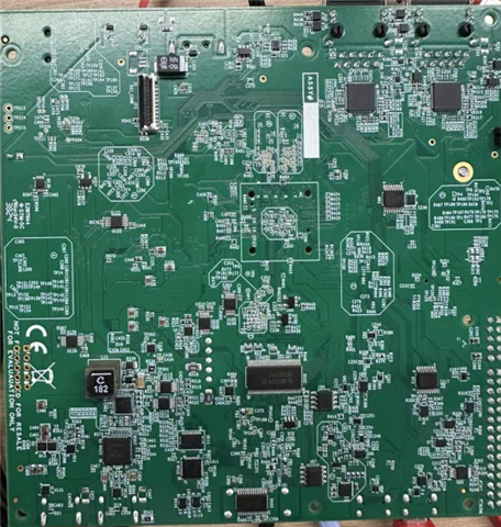

  • Hello Mazel,
    I am able to replicate your observation that watchdog is not rebooting the board. Can you please verify for me exactly which revision of the AM62L board you are using? (just in case that matters) Feel free to attach a picture of the EVM.
    Nick
    Thanks for the test, I don't have the version info for EVM but the picture is below:
