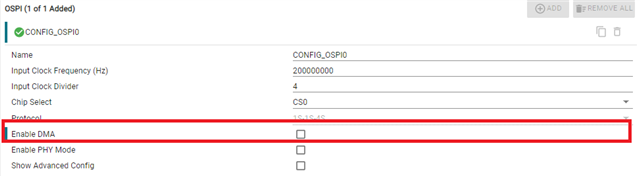

My SBL starts from 'mcu_plus_sdk_am64x_11_00_00_15\examples\drivers\boot\sbl_ospi', I failed to boot the application, and got the following error:
Boot from factory bank......
TR Response failed for transfer : SRC = 0x61000000, DST = 0x84000000, SIZE = 32
ASSERT: 18.407657s: ospi/v0/lld/dma/udma/ospi_udma_lld.c:OSPI_udmaUpdateSubmitTR:259: FALSE failed !!!
if I disable the 'Enable DMA' while config OSPI flash, application can be boot.

  • Hi Meet,
    I'm using a custom board, I'm using the default sbl_ospi with only DDR and flash configuration is changed through 'example.cfg'.
    One more information is that everything run well with SDK'mcu_plus_sdk_am64x_10_00_00_20'.
    Looks like with new SDK, and while do secure boot, there's some special offset can not be read with 'DMA is enabled'.

    offset: 0x61000000, should means the offset 0x01000000 of flash, right? because in direct read mode, flash data is mapped to memory start at 0x60000000, right?
  • offset: 0x61000000, should means the offset 0x01000000 of flash, right? because in direct read mode, flash data is mapped to memory start at 0x60000000, right?
    That is correct.
    The default offset is 0x80000 so the offset in your logs is unexpected.

    I found the root cause is the sequence of some initial code: 'system_init(), Bootloader_socOpenFirewalls()' etc. See below code snippet.
    #if 1 //can boot // from SDK:mcu_plus_sdk_am64x_11_00_00_15
    System_init();
    Bootloader_profileAddProfilePoint("System_init");
    Bootloader_socOpenFirewalls();
    Bootloader_socNotifyFirewallOpen();
    #else //can not boot // from SDK:mcu_plus_sdk_am64x_10_00_00_20
    Bootloader_profileAddProfilePoint("SYSFW init");
    System_init();
    #endif
    Drivers_open();
    Bootloader_profileAddProfilePoint("Drivers_open");
    So seems new SDK(mcu_plus_sdk_am64x_11_00_00_15) has specially adjusted the sequence, what's the aim for?

    I am not sure if I am following the issue. Here, you say the boot is successful with SDK v11.0 but is unsuccessful with SDK v10.0. But previously, you communicated the issue other way around.
    In any case, the order in the SDK v11.0 is correct. The order is fixed by the following commit:
    am64x,am243x: sbl: Move open firewall apis after system_init · TexasInstruments/mcupsdk-core@71cc503
    Prashant
  • Hi Prashant,
    Our SBL's initial code has not be changed when we moved to new SDK v11.0. Suppose that's why previous 'OSPI_udma() assert issue' occurs.
    so from the comment of commit, suppose we need to adjust the initial code accordingly to support secure boot, right?
    That seems to be the case. It is recommended to once evaluate the changes for the SBL OSPI between the two versions and accordingly backport the required changes.
