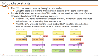

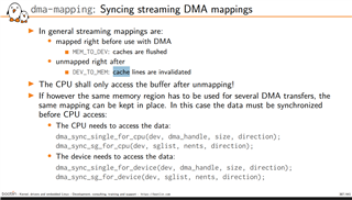

  • Hi DaeWon,
    I am not too savvy with Windows method for handling cache. However, I can point to some material for Linux:
    Specifically, this slide:
    And this slide:
    As for some experiments, can you try writing without EDMA? If direct CPU writes work, then it will make EDMA set up and cache a bit more suspicious.
    Takuma
