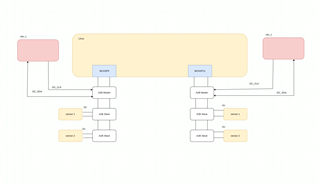

This is my design:
I want to get the audio data from the sensor through mcasp0 and mcasp11.
The configuration of the A2B daisy chain is configured through the I2C of c6x_1.
How can I modify the device tree to create two sound cards (mcasp0 and mcasp11) in Linux to get the audio data from the two sound cards?

    The reference link you gave is very helpful, but actually my problem is not solved. Here are my debugging methods and questions:
    1), I use A2B chip also AD2428.In normal applications, I have integrated or write the AD2428 codec driver, but in fact, the configuration of AD2428 is   completed on C6X_1 (through I2C, but this I2C is also configured with other A2B chips, so it cannot be used on Linux), so it is impossible to add the AD2428 codec driver in Linux. So I still need codec???
    2), I have I modified the dts and a dummy-codec:

    I can find tow snd in linux:
    When I use : arecord -D hw:1,0 -c 32 -f S32_LE -r 48000 -d 10 >> test.wav
    I can see the bclk waveform, but not the data (no data).
    Hope to get your support.
    Best Regards
    Eason
