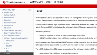

From the SDL introduction, it shall have example of LBIST, but I do not find it in the SDL example folder.
Which example include the LBIST demo?
