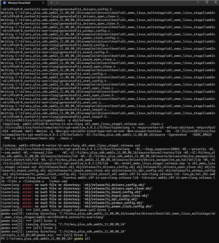

#1. gmake all  AM62x MCU plus SDK11.00, got error as below:
there is not such file in the folder:

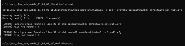

#2. Also can't flash sbl null
  • Hi Tony,
    Please tell what command have you run from the terminal?
    You need to build the sbl_uart_uniflash_stage2 image and also the ipc_rpmsg_echo_linux appimage to flash the SBL NULL.

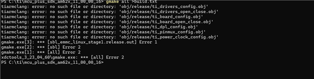

  • the same
    gmake all >build.txt
    7563.build.txt

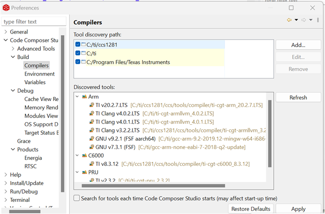

    Also I can see you are using TI ARM CLANG v4.0.2 but the recommended version is v4.0.1.
    Please follow the SDK_DOWNLOAD instructions.

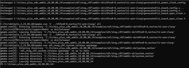

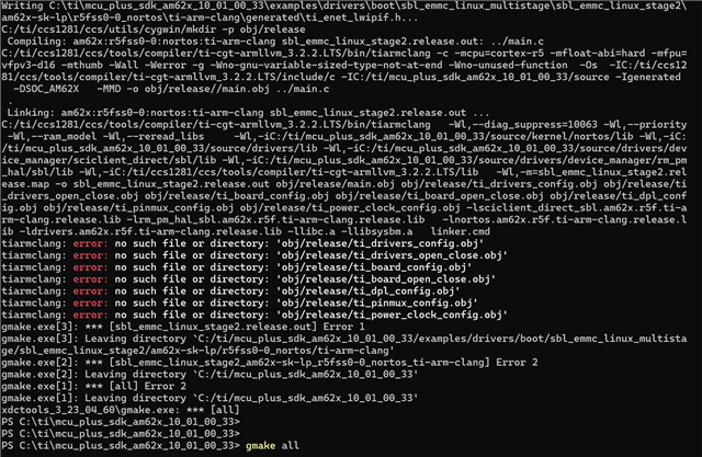

    There is same error when build 10.01..00.33, which use CLANG 3.2.2, CCS12.8.1
    Build success in 10.00.00.14 on the same computer.

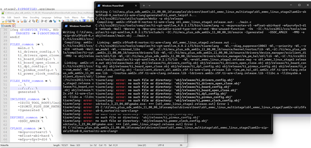

  • Here it is:
    Windows PowerShell
    Copyright (C) Microsoft Corporation. All rights reserved.
    Install the latest PowerShell for new features and improvements! https://aka.ms/PSWindows
    PS C:\ti\mcu_plus_sdk_am62x_11_00_00_16\examples\drivers\boot\sbl_emmc_linux_multistage\sbl_emmc_linux_stage2\am62x-sk-lp\r5fss0-0_nortos\ti-arm-clang>
    PS C:\ti\mcu_plus_sdk_am62x_11_00_00_16\examples\drivers\boot\sbl_emmc_linux_multistage\sbl_emmc_linux_stage2\am62x-sk-lp\r5fss0-0_nortos\ti-arm-clang> gmake all
    Generating SysConfig files ...
    C:/ti/sysconfig_1.23.1/nodejs/node C:/ti/sysconfig_1.23.1/dist/cli.js --product C:/ti/mcu_plus_sdk_am62x_11_00_00_16/.metadata/product.json --device AM62x --context r5fss0-0 --part Default --package AMC --output generated/ ../example.syscfg
    Running script...
    Validating...
    Generating Code (example.syscfg)...
    Writing C:\ti\mcu_plus_sdk_am62x_11_00_00_16\examples\drivers\boot\sbl_emmc_linux_multistage\sbl_emmc_linux_stage2\am62x-sk-lp\r5fss0-0_nortos\ti-arm-clang\generated\ti_dpl_config.c...
    Writing C:\ti\mcu_plus_sdk_am62x_11_00_00_16\examples\drivers\boot\sbl_emmc_linux_multistage\sbl_emmc_linux_stage2\am62x-sk-lp\r5fss0-0_nortos\ti-arm-clang\generated\ti_dpl_config.h...
    Writing C:\ti\mcu_plus_sdk_am62x_11_00_00_16\examples\drivers\boot\sbl_emmc_linux_multistage\sbl_emmc_linux_stage2\am62x-sk-lp\r5fss0-0_nortos\ti-arm-clang\generated\ti_drivers_config.c...
    Writing C:\ti\mcu_plus_sdk_am62x_11_00_00_16\examples\drivers\boot\sbl_emmc_linux_multistage\sbl_emmc_linux_stage2\am62x-sk-lp\r5fss0-0_nortos\ti-arm-clang\generated\ti_drivers_config.h...
    Writing C:\ti\mcu_plus_sdk_am62x_11_00_00_16\examples\drivers\boot\sbl_emmc_linux_multistage\sbl_emmc_linux_stage2\am62x-sk-lp\r5fss0-0_nortos\ti-arm-clang\generated\ti_drivers_open_close.c...
    Writing C:\ti\mcu_plus_sdk_am62x_11_00_00_16\examples\drivers\boot\sbl_emmc_linux_multistage\sbl_emmc_linux_stage2\am62x-sk-lp\r5fss0-0_nortos\ti-arm-clang\generated\ti_drivers_open_close.h...
    Writing C:\ti\mcu_plus_sdk_am62x_11_00_00_16\examples\drivers\boot\sbl_emmc_linux_multistage\sbl_emmc_linux_stage2\am62x-sk-lp\r5fss0-0_nortos\ti-arm-clang\generated\ti_pinmux_config.c...
    Writing C:\ti\mcu_plus_sdk_am62x_11_00_00_16\examples\drivers\boot\sbl_emmc_linux_multistage\sbl_emmc_linux_stage2\am62x-sk-lp\r5fss0-0_nortos\ti-arm-clang\generated\ti_power_clock_config.c...
    Writing C:\ti\mcu_plus_sdk_am62x_11_00_00_16\examples\drivers\boot\sbl_emmc_linux_multistage\sbl_emmc_linux_stage2\am62x-sk-lp\r5fss0-0_nortos\ti-arm-clang\generated\ti_board_config.c...
    Writing C:\ti\mcu_plus_sdk_am62x_11_00_00_16\examples\drivers\boot\sbl_emmc_linux_multistage\sbl_emmc_linux_stage2\am62x-sk-lp\r5fss0-0_nortos\ti-arm-clang\generated\ti_board_config.h...
    Writing C:\ti\mcu_plus_sdk_am62x_11_00_00_16\examples\drivers\boot\sbl_emmc_linux_multistage\sbl_emmc_linux_stage2\am62x-sk-lp\r5fss0-0_nortos\ti-arm-clang\generated\ti_board_open_close.c...
    Writing C:\ti\mcu_plus_sdk_am62x_11_00_00_16\examples\drivers\boot\sbl_emmc_linux_multistage\sbl_emmc_linux_stage2\am62x-sk-lp\r5fss0-0_nortos\ti-arm-clang\generated\ti_board_open_close.h...
    Writing C:\ti\mcu_plus_sdk_am62x_11_00_00_16\examples\drivers\boot\sbl_emmc_linux_multistage\sbl_emmc_linux_stage2\am62x-sk-lp\r5fss0-0_nortos\ti-arm-clang\generated\ti_enet_config.c...
    Writing C:\ti\mcu_plus_sdk_am62x_11_00_00_16\examples\drivers\boot\sbl_emmc_linux_multistage\sbl_emmc_linux_stage2\am62x-sk-lp\r5fss0-0_nortos\ti-arm-clang\generated\ti_enet_config.h...
    Writing C:\ti\mcu_plus_sdk_am62x_11_00_00_16\examples\drivers\boot\sbl_emmc_linux_multistage\sbl_emmc_linux_stage2\am62x-sk-lp\r5fss0-0_nortos\ti-arm-clang\generated\ti_enet_open_close.c...
    Writing C:\ti\mcu_plus_sdk_am62x_11_00_00_16\examples\drivers\boot\sbl_emmc_linux_multistage\sbl_emmc_linux_stage2\am62x-sk-lp\r5fss0-0_nortos\ti-arm-clang\generated\ti_enet_open_close.h...
    Writing C:\ti\mcu_plus_sdk_am62x_11_00_00_16\examples\drivers\boot\sbl_emmc_linux_multistage\sbl_emmc_linux_stage2\am62x-sk-lp\r5fss0-0_nortos\ti-arm-clang\generated\ti_enet_soc.c...
    Writing C:\ti\mcu_plus_sdk_am62x_11_00_00_16\examples\drivers\boot\sbl_emmc_linux_multistage\sbl_emmc_linux_stage2\am62x-sk-lp\r5fss0-0_nortos\ti-arm-clang\generated\ti_enet_lwipif.c...
    Writing C:\ti\mcu_plus_sdk_am62x_11_00_00_16\examples\drivers\boot\sbl_emmc_linux_multistage\sbl_emmc_linux_stage2\am62x-sk-lp\r5fss0-0_nortos\ti-arm-clang\generated\ti_enet_lwipif.h...
    C:/ti/ccs2011/ccs/utils/cygwin/mkdir -p obj/release
     Compiling: am62x:r5fss0-0:nortos:ti-arm-clang sbl_emmc_linux_stage2.release.out: ../main.c
    C:/ti/ccs2011/ccs/tools/compiler/ti-cgt-armllvm_4.0.2.LTS/bin/tiarmclang -c -mcpu=cortex-r5 -mfloat-abi=hard -mfpu=vfpv3-d16 -mthumb -Wall -Werror -g -Wno-gnu-variable-sized-type-not-at-end -Wno-unused-function  -Os  -IC:/ti/ccs2011/ccs/tools/compiler/ti-cgt-armllvm_4.0.2.LTS/include/c -IC:/ti/mcu_plus_sdk_am62x_11_00_00_16/source -Igenerated   -DSOC_AM62X   -MMD -o obj/release//main.obj ../main.c
     Linking: am62x:r5fss0-0:nortos:ti-arm-clang sbl_emmc_linux_stage2.release.out ...
    C:/ti/ccs2011/ccs/tools/compiler/ti-cgt-armllvm_4.0.2.LTS/bin/tiarmclang   -Wl,--diag_suppress=10063 -Wl,--priority -Wl,--ram_model -Wl,--reread_libs     -Wl,-iC:/ti/mcu_plus_sdk_am62x_11_00_00_16/source/kernel/nortos/lib -Wl,-iC:/ti/mcu_plus_sdk_am62x_11_00_00_16/source/drivers/lib -Wl,-iC:/ti/mcu_plus_sdk_am62x_11_00_00_16/source/drivers/device_manager/sciclient_direct/sbl/lib -Wl,-iC:/ti/mcu_plus_sdk_am62x_11_00_00_16/source/drivers/device_manager/rm_pm_hal/sbl/lib -Wl,-iC:/ti/ccs2011/ccs/tools/compiler/ti-cgt-armllvm_4.0.2.LTS/lib   -Wl,-m=sbl_emmc_linux_stage2.release.map -o sbl_emmc_linux_stage2.release.out obj/release/main.obj obj/release/ti_drivers_config.obj obj/release/ti_drivers_open_close.obj obj/release/ti_board_config.obj obj/release/ti_board_open_close.obj obj/release/ti_dpl_config.obj obj/release/ti_pinmux_config.obj obj/release/ti_power_clock_config.obj -lsciclient_direct_sbl.am62x.r5f.ti-arm-clang.release.lib -lrm_pm_hal_sbl.am62x.r5f.ti-arm-clang.release.lib   -lnortos.am62x.r5f.ti-arm-clang.release.lib -ldrivers.am62x.r5f.ti-arm-clang.release.lib -llibc.a -llibsysbm.a   linker.cmd
    tiarmclang: error: no such file or directory: 'obj/release/ti_drivers_config.obj'
    tiarmclang: error: no such file or directory: 'obj/release/ti_drivers_open_close.obj'
    tiarmclang: error: no such file or directory: 'obj/release/ti_board_config.obj'
    tiarmclang: error: no such file or directory: 'obj/release/ti_board_open_close.obj'
    tiarmclang: error: no such file or directory: 'obj/release/ti_dpl_config.obj'
    tiarmclang: error: no such file or directory: 'obj/release/ti_pinmux_config.obj'
    tiarmclang: error: no such file or directory: 'obj/release/ti_power_clock_config.obj'
    xdctools_3_23_04_60\gmake.exe: *** [sbl_emmc_linux_stage2.release.out] Error 1

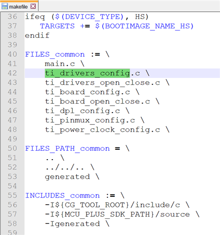

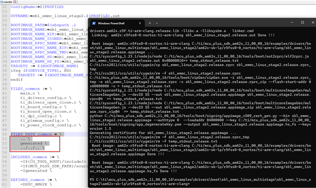

  • clean:
    From the error, there is not required .obj in the release folder,
    From the build log, those files are generated, but not compiled.
    those files are included to the project in makefile.
    Then I move the generated \ folder up in PATH as below, it can build success now.
    Same problem on building rest boards' folder if not change as upper.

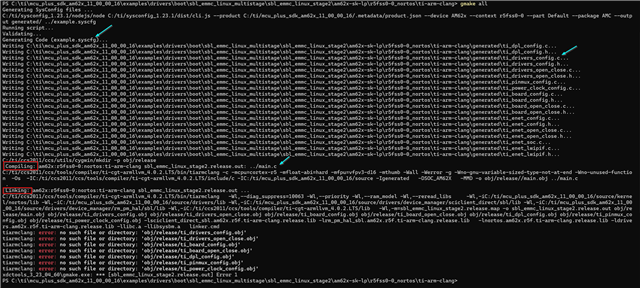

  • Please check the gmake version you are using. It should be greater than 3.81. You should ideally be using gmake that comes with the CCS installation.
  • PS C:\ti\mcu_plus_sdk_am62x_11_00_00_16\examples\drivers\boot\sbl_emmc_linux_multistage\sbl_emmc_linux_stage2\am62x-sip-sk\r5fss0-0_nortos\ti-arm-clang> gmake -v
    GNU Make 3.81
    Copyright (C) 2006 Free Software Foundation, Inc.
    This is free software; see the source for copying conditions.
    There is NO warranty; not even for MERCHANTABILITY or FITNESS FOR A
    PARTICULAR PURPOSE.
    This program built for Windows32
  • It should be greater than 3.81. You should ideally be using gmake that comes with the CCS installation.
    It is the problem. in my old environment was pioint to XDCTOOL folder. Change to CCS installation, can build now.
