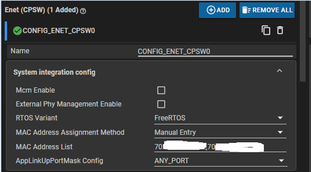

  • Further investigation, the problem will disappear if in the SYSCONFIG under TI NETWORKING for Enet (CPSW), under the tab System Integration Config
    I have to change "MAC Address Assignment Method" from "Auto Assign" to Manual Entry as shown here :
    After this I could run the Ethernet Loopback. So the question is on the bad board it will not work with "Auto Assign" for MAC address and on the good board it will work on both cases "Auto Assign" and "Manual Entry". Is there any situation that can cause this problem ? Could someone explain to me why it is behaving as such ?

  • Originally EVM test on Ethernet loopback test was working fine until the I2C device 0x50 (Board_ID EEPROM) was tested with writing large file (
    It seems that you have overwritten original MAC address of the EVM.
    I am adding HW expert here to help you out if there is a way.

    - I then changed the MAC add setting from "auto assign" to "manual entry" shown in the previous post and the ethernet loopback works but only works if the MAC addresses for 2 instances are set manually and would not work if set "auto assign" again.
    - It confirmed to me that these MAC addresses must be saved in some locations high up in the I2C device which were wiped out during I2C read/write exercise of a large file. I do not know for sure but usually the MAC addresses of the board are normally saved in the I2C
