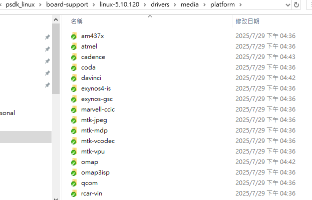

    Do you see V4L2 bitrate controls in the Linux driver when you search the code?
    Also could you please share the input stream that you are using? How long is the stream?
    Sarabesh S.
  • Hi Sarabesh,
    [otobrite] : Can you point out which source code is in the Linux driver you are talking about?
    [otobrite] : the streaming example(cmd) was provided by you, please see the upper messages.
  • Hi John,
    Yes, the source code is located in the linux kernel in drivers/media/platform/chipsnmedia/wave5.

  • Hi Sarabesh,
    we can't find chipsnmedia folder on linux kernel,
    we just can find wave5 folder on psdk_linux/board-support/linux-5.10.120/drivers/staging/media/wave5.
    please help.
  • Let me confirm the path on the older kernel and get back to you.
    Sarabesh S.
  • Hi Sarabesh,
    This issue is urgent, how about the status?
  • Hi John, apologies bandwidth has been limited. Yes I can confirm that the path is being used for the driver. I am still investigating whether bitrate control (and to what extent) is enabled in this version of the driver. It does look like the correct registers are being written to but some controls are missing.
  • Hi John,
    Please take a look at SDK 8.6 and cherry pick the necessary patches to enable V4l2 bitrate controls.
    It appears a big revert to the wave5 codebase was done on the update from 8.4 to 8.6 SDK. The commits for reverting and adding the new v4l2 layer are listed below.
    The driver took a big rework between those SDKs but it did happen on the same kernel version. We won't be able to provide any backport support so please proceed with the resources from the git tree.
    Thank you,
    Sarabesh S.
