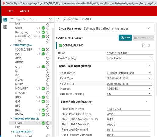

    My first pointer would go to check the device type you are using. You can do so by referring this guide: https://e2e.ti.com/support/processors-group/processors/f/processors-forum/1228618/faq-am6xx-how-to-check-if-device-type-is-hs-se-hs-fs-or-gp
    My second pointer would be to use the correct images, I see that the thread has been created with AM62x-SK-LP as the Part Number, so I am assuming you would need to go for the files in the third directory:
    Please let me know your thoughts on this one.
    Respectfully,
    Vaibhav
  • I also believe so if the TI EVM would have been the following: https://www.ti.com/tool/SK-AM62B-P1
    Then it would have been okay to refer the configuration files from the second directory which is am62x-sk.
    Let me know your thoughts on this as well.
  • Hi Vaibhav,
    For your 1st point, I have checked its HS-FS deivce.
    For the 2nd point, am using customized am62x-sk-lp device, it has NOR Chip (winbond) instead of NAND, so in am62x-sk-lp don't have examples for sbl_ospi_linux_multistage.cfg for Nor-chip, So that's why am using am62x-sk .cfg.
  • Hi Manu,
    Thanks for clarifying.
    Since you have just changed the flash from NAND to NOR, it would be great if you can go ahead and modify the example.sysconfig file of all the applications which has OSPI/FLASH added by default and change it to make it work for NOR flash instead of NAND flash under the am62x-sk-lp examples.
    Hope you get my point, let me know know if you need further help with anything else.

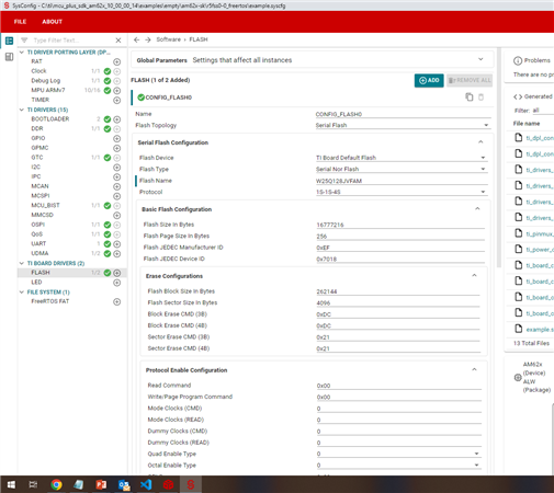

  • Hi Vaibhav,
    I have modified example.syscfg in the path C:\ti\mcu_plus_sdk_am62x_10_00_00_14\examples\drivers\boot\sbl_ospi_linux_multistage\sbl_ospi_linux_stage1\am62x-sk\r5fss0-0_nortos and board_IpaddrReginit.h file in C:\ti\mcu_plus_sdk_am62x_10_00_00_14\source\drivers\ddr\v0\soc\am62x.
    And I build the mcu_sdk with cmd make -s BOARD=am62x-sk all

    Can you share your sysconfig file here which has the OSPI changes for the am62-sk-lp examples?
    Vaibhav
  • Hi Vaibhav,

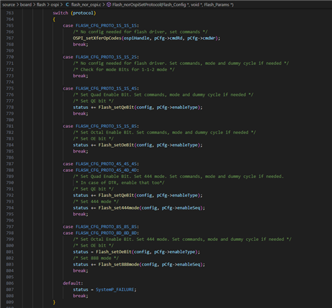

    Am using Winbond Nor chip, Also I think all the flash and other functions are calling
      .fxns = &gFlashNorOspiFxns,
     instead need to call gFlashNorQspiFxns. also please the read/write command ID's related to SPI nor

  • gFlashNorQspiFxns
    The following need not be called, as the Flash NOR OSPI Apis itself takes care of the QSPI operations if any.
    The main part is the protocol set function.
    Please see the following snippet from the file flash_nor_ospi.c file.

  • Hi Manu,
    I have reviewed the sysconfig file that you shared.
    What seemed strange to me was that the read and write commands were not written.
    Please refer this guide to setup the QSPI flash: https://e2e.ti.com/support/processors-group/processors/f/processors-forum/1500011/faq-mcu-plus-sdk-am62x-how-to-interface-qspi-flash-part
    Let me know if you need further help in understanding the FAQ.
    Vaibhav
  • Hi Vaibhav,
    First thing am not able to see the ospi_flash_diag example in mentioned path.
    2nd thing is after building ospi_flash_diag example how to flash, do we have any default.cfg file are there to flash using python?
    I have referred the link you have mentoned.
  • Hi Manu,
    I see that OSPI Flash Diag example in the latest SDK for AM62x.
    But it is not available for AM62x-sk-lp.
    So for this, I would like you to pick an empty example and convert it/make it function like ospi flash diag.
    Let me know if you run into any problems.

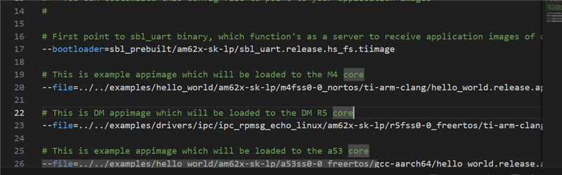

  • HI Vaibhav,
    Is it possible to flash the OSPI flash diagnostics application using lauterbach? will that supports? because lauterbach supports to our customized board.
  • And also we are using Trace32 for flashing
  • Hi Manu,
    Thanks for waiting.
    Does the lauterbach has its own application/UI to flash the QSPI?
    I think, instead of this, you can try to flash via UART, and use the file for sbl uart that is: default_sbl_uart_hs_fs.cfg file
    For this your command would look like: python uart_bootloader.py -p COM<X> --cfg=PATH_TO_default_sbl_uart_hs_fs.cfg
    Inside the cfg file, you would need to give the path to the ospi flash diagnostics(which you must have ported to empty application for am62x-sk-lp example).
    Here you just replace the line 22:
    Vaibhav
