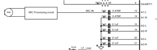

  • The microphone is connected directly (not through a jack) using the IN1_L pin, and speaker output is routed via HP_L.
  • We've reused the same amixer settings and device tree configuration that worked on NXP platforms.
    Any widgets or routing issues for MIC from TLV320AIC3204 to AM6252 via I2S McASP.  ?

  • Hi Suren,
    We are not using Mic bias just kept NC and we are generating MIC supply externally in our board .

  • Hi Nuthula Shekar,
    I see that you have configured IN1_L mixer control and not the other Line In related controls?
    Can you try using amixer cset commands to set those and also try changing the resistors to 20kohm resistors and see if it helps.

  • Hi Suren,
    I have mentioned all the amixer controls that I am able to see. Could you please be more specific about what else needs to be modified? I have also changed the resistor to 20k, but it is still not working.
    Can you attach your schematic here as well? I notice that you have the Right Mixer negative resistor set to CM, but nothing on the positive side. I see that you have the left mixer positive and negative set up correctly for IN1L on the left ADC. Can you attach a register dump of the AIC3204? Also, can you make sure that there is a signal output at the IN1L pin on a scope?

    and there is no signal on In1_L pin . Schematic is shared with your TI team via mail to Lakshmi narashimhan and  Anatya vallabh.
  • Shekar,
    I didn't understand what you mean by there is no signal on IN1_L PIN.
    - Can you take a look at the schematic shared via email?
    Suren
    Here is the input circuit from the schematic shared via email. If you are not getting any signal at the IN1L pin, then there may be an issue with the "mic processing circuit" shown here. From the amixer configuration, it shows you are expecting signal on the IN1L pin, and the schematic shows this as well. Can you show what the mic processing circuit is so we can help figure out why you are not getting a mic signal?
    Mir
  • Hi Mir,
    The mic processing circuit is working with other NXP-based processors using the same TLV320AIC3204 device; however, it is failing in this case. When I try to record using arecord with the TI AM6252, there is no signal on the DOUT pin, whereas with other processors, I can see activity on the DOUT line .

    Here sound1 ,tlv320aic3204  and McASP1 are node's  which i added  .
