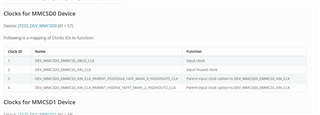

Hi expert,
In order to avoid the EMC sensitive frequency, our customer need to modify the eMMC clock from 200M to 117M. We have successfully modified it by Linux command devmem2 0x00682088 w 0x8010. But we would like to know how to modify it in the original eMMC driver? Thanks
