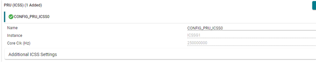

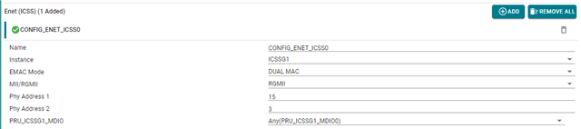

From what I understand, the DMA is well used and we configure the PRU in the sysconfig as follows:
I am aware of not giving much information but I do not know what to provide.

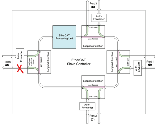

    The way we have proceeded is perhaps not very scientific but the order of magnitude and quite correct. Side of the slave network we instrumented ourselves on the first slave of the network (so the last slave to return the frame to the master once it transited over the network) a signal on port 0. This signal is trigged when the last byte of the EtherCAT frame passes through this port (see red cross in the diagram).
    The time between this latched time and the arrival of the full frame on the PHY of the sitara is very low because it is just the circulation time on the ethernet cable and the decoding time of the PHY of the master.
    On the side of our application, there is in the SOEM stack a "ecx_receive_processdata_group" function which itself contains an "ecx_waitinframe" function. We set up a measurement point in this "ecx_waitinframe" function, once the frame was available in our application.
    Please let me know if this is not clear to you.

  • The way we have proceeded is perhaps not very scientific but the order of magnitude and quite correct. Side of the slave network we instrumented ourselves on the first slave of the network (so the last slave to return the frame to the master once it transited over the network) a signal on port 0. This signal is trigged when the last byte of the EtherCAT frame passes through this port (see red cross in the diagram).
    This also assumes no system time offset between SOEM Main-Device and first Sub-Device? Are you measuring this with DC enabled?
  • Yes, DC feature is enabled. But I don't get the idea with the system time offset. How could this have an impact on the measured time?
    You are comparing the time captured in S-device with timer in M-Device?
  • Yes we measured the time between the last byte of the frame leaves the first slave of the network (which is therefore the last through which the frame passes on the return) before the frame is actually available in our application.
