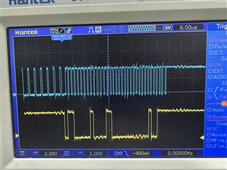

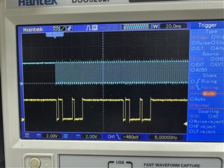

In u-boot (2023.04), the RTL9010ARG is properly recognized through MDIO and PHY initialization is performed successfully (see logs below).
However, in QNX 7.1, the RTL9010ARG PHY is not communicating properly through MDIO.
I would appreciate it if you could help identify the reason why communication is not working.

=> mdio read ethernet@c200000port@1 0.2
Reading from bus ethernet@c200000port@1
PHY at address 1:
[MDIO-DBG] cpsw_mdio_disable:99: MDIO controller disabled, CONTROL=0x8104013f
[MDIO-DBG] cpsw_mdio_enable_manual_mode:110: MDIO manual mode enabled, POLL=0x80000000
[MDIO-DBG] cpsw_mdio_sw_read:246: SW Read PHY 1 Reg 0x02 = 0x001c
0.2 - 0x1c
=> mdio read ethernet@c200000port@1 0.3
PHY at address 1:
[MDIO-DBG] cpsw_mdio_sw_read:246: SW Read PHY 1 Reg 0x03 = 0xcb30
0.3 - 0xcb30
=> mdio read ethernet@c200000port@1 0.1
PHY at address 1:
[MDIO-DBG] cpsw_mdio_sw_read:246: SW Read PHY 1 Reg 0x01 = 0x0009
0.1 - 0x9

J721S2-ICMU@QNX:/# io-pkt-v6-hc -d /ti_fs/tilib/devnp-cpsw2g-main.so verbose=0xff
J721S2-ICMU@QNX:/# May 22 11:55:10.779                   iopkt.421896                           0  -----ONLINE-----
May 22 11:55:10.779                   iopkt.421896          main_buffer*     0  tcpip starting
May 22 11:55:10.780                   iopkt.421896          main_buffer      0  smmu support is disabled
May 22 11:55:10.781                   iopkt.421896          main_buffer      0  initializing IPsec...
May 22 11:55:10.781                   iopkt.421896          main_buffer      0   done
May 22 11:55:10.781                   iopkt.421896          main_buffer      0  IPsec: Initialized Security Association Processing.
May 22 11:55:10.827                   iopkt.421896          main_buffer      0  /ti_fs/tilib/devnp-cpsw2g-main.so verbose=0xff
May 22 11:55:10.828            io_pkt_v6_hc.421896                           0  -----ONLINE-----
May 22 11:55:10.828                   iopkt.421896          main_buffer      0  ao0
May 22 11:55:10.828            io_pkt_v6_hc.421896                 slog*     0  cpsw_entry:577 Entry -->
May 22 11:55:10.828            io_pkt_v6_hc.421896                 slog      0  cpsw_attach:751 Entry -->
May 22 11:55:10.828            io_pkt_v6_hc.421896                 slog      0  cpsw_parse_options:217 Verbose -->255
May 22 11:55:10.828            io_pkt_v6_hc.421896                 slog      0  bsd_mii_initmedia:267 Came here -->
May 22 11:55:10.828            io_pkt_v6_hc.421896                 slog      0  Success - write to MAIN_ENET_CTRL - 0x12
May 22 11:55:10.828            io_pkt_v6_hc.421896                 slog      0  Success - write to MAIN CPSW2_CLKSEL - 0x0
May 22 11:55:10.828            io_pkt_v6_hc.421896                 slog      0  PINMUX for 0x941f80c0=0x50006 (org=0x10006)
May 22 11:55:10.828            io_pkt_v6_hc.421896                 slog      0  PINMUX for 0x941f80bc=0x50006 (org=0x50006)
May 22 11:55:10.828            io_pkt_v6_hc.421896                 slog      0  PINMUX for 0x941f80b8=0x50006 (org=0x50006)
May 22 11:55:10.828            io_pkt_v6_hc.421896                 slog      0  PINMUX for 0x941f80a0=0x50006 (org=0x50006)
May 22 11:55:10.828            io_pkt_v6_hc.421896                 slog      0  PINMUX for 0x941f80a4=0x50006 (org=0x50006)
May 22 11:55:10.828            io_pkt_v6_hc.421896                 slog      0  PINMUX for 0x941f80a8=0x50006 (org=0x50006)
May 22 11:55:10.828            io_pkt_v6_hc.421896                 slog      0  PINMUX for 0x941f80b0=0x50006 (org=0x50006)
May 22 11:55:10.828            io_pkt_v6_hc.421896                 slog      0  PINMUX for 0x941f80ac=0x50006 (org=0x50006)
May 22 11:55:10.828            io_pkt_v6_hc.421896                 slog      0  PINMUX for 0x941f808c=0x50006 (org=0x10006)
May 22 11:55:10.828            io_pkt_v6_hc.421896                 slog      0  PINMUX for 0x941f8090=0x50006 (org=0x10006)
May 22 11:55:10.828            io_pkt_v6_hc.421896                 slog      0  PINMUX for 0x941f8094=0x50006 (org=0x10006)
May 22 11:55:10.828            io_pkt_v6_hc.421896                 slog      0  PINMUX for 0x941f8098=0x50006 (org=0x10006)
May 22 11:55:10.828            io_pkt_v6_hc.421896                 slog      0  PINMUX for 0x941f80b4=0x50006 (org=0x10006)
May 22 11:55:10.828            io_pkt_v6_hc.421896                 slog      0  PINMUX for 0x941f809c=0x50006 (org=0x10006)
May 22 11:55:10.828            io_pkt_v6_hc.421896                 slog      0  cpsw2g-main
May 22 11:55:10.828            io_pkt_v6_hc.421896                 slog      0  Vendor .............. 0x0
May 22 11:55:10.828            io_pkt_v6_hc.421896                 slog      0  Device .............. 0x0
May 22 11:55:10.828            io_pkt_v6_hc.421896                 slog      0  Revision ............ 0x0
May 22 11:55:10.828            io_pkt_v6_hc.421896                 slog      0  I/O port base ....... 0xc200000
May 22 11:55:10.828            io_pkt_v6_hc.421896                 slog      0  MAC address ......... 70ff76 1d92c1
J721S2-ICMU@QNX:/# ifconfig ao0 192.168.3.20 netmask 255.255.255.0 up
May 22 11:55:45.625            io_pkt_v6_hc.421896                 slog      0  cpsw_ioctl:386 Came here -->cmd-0x8090690c
May 22 11:55:45.625            io_pkt_v6_hc.421896                 slog      0  cpsw_init:1049 Entry -->
May 22 11:55:45.625            io_pkt_v6_hc.421896                 slog      0  Enabling clocks!
May 22 11:55:45.626            io_pkt_v6_hc.421896                 slog      0  EnetIf_reduceCoreMacAllocation: Reduced Mac Address Allocation for CoreId:3 From 1 To 0
May 22 11:55:45.626            io_pkt_v6_hc.421896                 slog      0  ENET_CPSW_2G on MAIN NAVSS
May 22 11:55:45.630            io_pkt_v6_hc.421896                 slog     56  [UDMA] Calling Udma_resmgr_open
May 22 11:55:45.630            io_pkt_v6_hc.421896                 slog     56  [UDMA] Opening resmgr!!!
May 22 11:55:45.630            io_pkt_v6_hc.421896                 slog     56  [UDMA] Opened resmgr fd=6!!!
May 22 11:55:45.630            io_pkt_v6_hc.421896                 slog     56  [UDMA] eventHandle->vintrNum = 35!!!
May 22 11:55:45.630            io_pkt_v6_hc.421896                 slog     56  [UDMA] eventHandle->irIntrNum = 11!!!
May 22 11:55:45.630            io_pkt_v6_hc.421896                 slog     56  [UDMA] eventHandle->coreIntrNum = 75!!!
May 22 11:55:45.637            io_pkt_v6_hc.421896                 slog      0  EnetIf_registerIntr2: tx isr 75 thread priority set to 21
May 22 11:55:45.637            io_pkt_v6_hc.421896                 slog      0  EnetIf_CreateISRThread: InterruptAttachEvent succeed irq/75 coid/1073741848 event/3
May 22 11:55:45.637            io_pkt_v6_hc.421896                 slog      0  Enet_open: main.cpsw2g: features: 0x00000002
May 22 11:55:45.637            io_pkt_v6_hc.421896                 slog      0  Enet_open: main.cpsw2g: errata  : 0x00000000
May 22 11:55:45.637            io_pkt_v6_hc.421896                 slog      0  Mdio_open: MDIO manual mode enabled
May 22 11:55:45.638            io_pkt_v6_hc.421896                 slog      0  cpsw_alloc:299: Alloc successfull; Virt: 0x199d19f000, Phys: 0x9ff290000
May 22 11:55:45.638            io_pkt_v6_hc.421896                 slog      0  EnetUdma_memMgrInit: addr=0x199d19f000 is  aligned
May 22 11:55:45.640            io_pkt_v6_hc.421896                 slog      0  EnetIf_registerIntr: some unknown cpsw isr thread priority set to 21
May 22 11:55:45.640            io_pkt_v6_hc.421896                 slog      0  EnetIf_CreateISRThread: InterruptAttachEvent succeed irq/51 coid/1073741852 event/10
May 22 11:55:45.640            io_pkt_v6_hc.421896                 slog      0  EnetIf_CreateISRThread: InterruptAttachEvent succeed irq/53 coid/1073741854 event/11
May 22 11:55:45.640            io_pkt_v6_hc.421896                 slog      0  %DEBUG: F=EnetPhy_open,L=281 PHY 0: open
May 22 11:55:45.640            io_pkt_v6_hc.421896                 slog      0  %DEBUG: F=EnetPhy_isAlive,L=513 PHY 0: isAlive {
May 22 11:55:45.772            io_pkt_v6_hc.421896                 slog      0  %DEBUG: F=EnetPhy_isAlive,L=519 hMdio->isAlive, status 0
May 22 11:55:45.772            io_pkt_v6_hc.421896                 slog      0  %DEBUG: F=EnetPhy_isAlive,L=537 } isAlive false
May 22 11:55:45.772            io_pkt_v6_hc.421896                 slog      0  EnetPhy_setNextState: PHY 0: INIT -> INIT (0 ticks)
May 22 11:55:45.772            io_pkt_v6_hc.421896                 slog      0  EnetPhy_open: PHY 0: open
May 22 11:55:45.773            io_pkt_v6_hc.421896                 slog      0  cpsw_alloc:299: Alloc successfull; Virt: 0x199d21b000, Phys: 0x9ff2a4000
May 22 11:55:45.773            io_pkt_v6_hc.421896                 slog      0  EnetIfMem_init: addr=0x199d21b000 is  aligned
May 22 11:55:45.773            io_pkt_v6_hc.421896                 slog      0  EnetIfMem_init: addr=0x199d21b000, size=0x221000, gMem=0x199d21b000, gMemBufPhys=0x9ff2a4000
May 22 11:55:45.773            io_pkt_v6_hc.421896                 slog      0  EnetIfMem_init: gDmaDescMemArray=0x199d21b000, size=0x200000
May 22 11:55:45.773            io_pkt_v6_hc.421896                 slog      0  EnetIfMem_init: gRingMemArray=0x199d41b000, size=0x21000
May 22 11:55:45.773            io_pkt_v6_hc.421896                 slog      0  EnetIfMem_init: gDmaDescMemArrayBasePhys=0x9ff2a4000, gDmaDescMemArrayBase=0x199d21b000
May 22 11:55:45.776            io_pkt_v6_hc.421896                 slog      0  initQs() freePktInfoQ initialized with 256 pkts
May 22 11:55:45.778            io_pkt_v6_hc.421896                 slog     56  [UDMA] eventHandle->globalEvent = 34!!!
May 22 11:55:45.778            io_pkt_v6_hc.421896                 slog     56  [UDMA] eventHandle->vintrNum = 36!!!
May 22 11:55:45.779            io_pkt_v6_hc.421896                 slog     56  [UDMA] eventHandle->vintrBitNum = 0!!!
May 22 11:55:45.779            io_pkt_v6_hc.421896                 slog     56  [UDMA] eventHandle->irIntrNum = 12!!!
May 22 11:55:45.779            io_pkt_v6_hc.421896                 slog     56  [UDMA] eventHandle->coreIntrNum = 76!!!
May 22 11:55:45.792            io_pkt_v6_hc.421896                 slog      0  EnetIf_registerIntr2: rx isr 76 thread priority set to 21
May 22 11:55:45.792            io_pkt_v6_hc.421896                 slog      0  EnetIf_registerIntr2: RX InterruptAttachEvent succeed irq/76 coid/1073741855 event/12
May 22 11:55:45.793            io_pkt_v6_hc.421896                 slog      0  Host MAC address:
May 22 11:55:45.793            io_pkt_v6_hc.421896                 slog      0  70:ff:76:1d:92:c1
May 22 11:55:49.986            io_pkt_v6_hc.421896                 slog      0  EnetPhy_setNextState: PHY 0: INIT -> FINDING (20 ticks)
May 22 11:55:54.180            io_pkt_v6_hc.421896                 slog      0  %DEBUG: F=EnetPhy_isAlive,L=537 } isAlive false
May 22 11:55:54.281            io_pkt_v6_hc.421896                 slog      0  %DEBUG: F=EnetPhy_isAlive,L=513 PHY 0: isAlive {
J721S2-ICMU@QNX:/# May 22 11:55:54.413            io_pkt_v6_hc.421896                 slog      0  %DEBUG: F=EnetPhy_isAlive,L=519 hMdio->isAlive, status 0
May 22 11:55:54.413            io_pkt_v6_hc.421896                 slog      0  %DEBUG: F=EnetPhy_isAlive,L=537 } isAlive false
May 22 11:55:54.413            io_pkt_v6_hc.421896                 slog      0  cpsw_init:1127 Phy is not linked
May 22 11:55:54.413            io_pkt_v6_hc.421896                 slog      0  cpsw_init:1154 <--Exit
May 22 11:55:54.413            io_pkt_v6_hc.421896                 slog      0  cpsw_ioctl:472 <--
May 22 11:55:54.413            io_pkt_v6_hc.421896                 slog      0  cpsw_ioctl:386 Came here -->cmd-0x80906931
May 22 11:55:54.413            io_pkt_v6_hc.421896                 slog      0  cpsw_filter: Clear IFF_ALLMULTI
May 22 11:55:54.413            io_pkt_v6_hc.421896                 slog      0  cpsw_filter: Adding Multicast MAC Addr -> 33:33:ff:1d:92:c1
May 22 11:55:54.413            io_pkt_v6_hc.421896                 slog      0  cpsw_filter: Adding Multicast MAC Addr -> 33:33:00:00:00:01
May 22 11:55:54.413            io_pkt_v6_hc.421896                 slog      0  cpsw_ioctl:386 Came here -->cmd-0x80906910
May 22 11:55:54.413            io_pkt_v6_hc.421896                 slog      0  cpsw_init:1049 Entry -->
May 22 11:55:54.680            io_pkt_v6_hc.421896                 slog      0  cpsw_start:1290 Entry -->

    and I have checked MDIO pattern
    In uboot 2023.04, the waveform is like as follow:
    this works well.
    but in QNX it doesn't response from RTL9010 phy
    I think it's because of the MDC clock of TDA4AL.
    Would you help or comment on this issue more..
